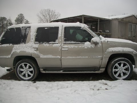

Hello: I drove my Escalade Tues Evening parked, went to leave next morning turns over but won't start. Check Engine light was on for a week felt like a O2 Sensor as gas mileage also went down hill. It was running fine no hesitation to start before Weds.
