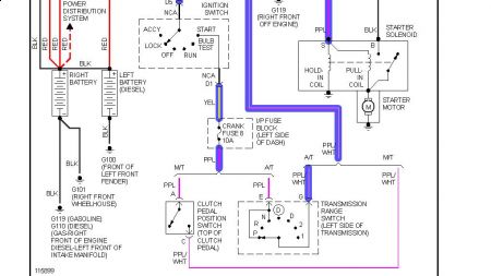

OK, this one has me stumped. A few weeks ago our Escalade wouldn't turn over. When the key was turned I would hear a loud click coming from the starter, nothing else. Eventually one of the clicks will catch and the truck will fire right up. It will only happen after it has been sitting overnight. On occassion, if I just hold the key in the start position it will fire after a 4-5 second delay. I have changed the starter, the starter relay and the fuel pump. Once it has started, it fires right up every time for the rest of the day. When it doesn't turn over by key, it also will not start by remote. I just get the same clicking sound. If it's not the starter, the relay or the fuel pump, what else could it be that would affect the key and remote when starting?

Here are a few more things I just thought of. I have put a reader on it and no codes are found. Additionally, when I turn the key everything else comes on like it should. The battery voltage is 13.7 and the connections are tight and the battery tests fine under a load.

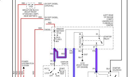

Hi pounders and TY for the donation You have replaced 2 components of the starting circuit-that is the starter and starter relay-Now its time to test the igniton switch and P/N switch
https://images.2carpros.com/forum/automotive_pictures/12900_start1_4.jpg
https://images.2carpros.com/forum/automotive_pictures/12900_start2_4.jpg

rasmataz, I have already tried putting the vehicle in neutral as well as any other gear to check to see if the shift position possibly had something to do with it. No luck. When it won't start, it won't start in any position. As far as the ignition goes, it will not remote start either, which bypasses the ignition switch, correct?
Remember, the car will eventually start after 6-7 tries clicking the switch back and forth or holding it in the start position.
I am leaning toward a bad starter or starter solenoid right now, even though it is brand new. The next time it does not start I am going to try to jump out the leads on the solenoid.

Understand okay short out the purple wire on the starter solenoid to the battery terminal on it-did the starter engage the engine? Nothing happens-drop the starter and take back where you got it-
