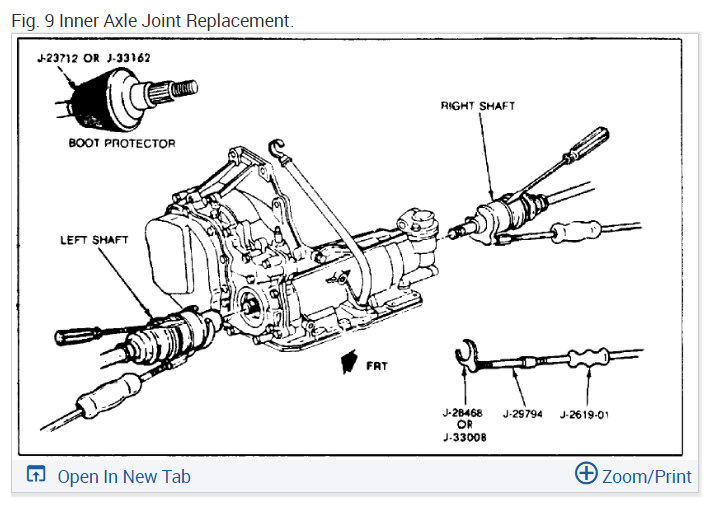

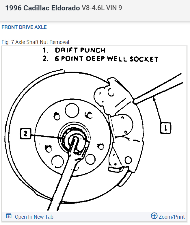

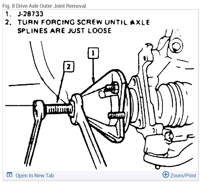

Yep, the CV drive axle can cause this issue. Here is how to change it out to help fix the problem.

2. Install a brass drift or a screwdriver to prevent the rotor from turning, Fig. 7 .
3. Remove axle nut and washer.

6. Remove drive axle from hub and bearing assembly using front hub spindle remover tool No. J-28733-A, or equivalent, Fig. 8 .
7. Remove drive axle from transaxle using axle shaft remover puller tool Nos. J-33008, J-29794 and slide hammer tool No. J-2619-01, or equivalents, if necessary, Fig. 9 .

1. Install drive axle into the transaxle using seal protector J-37292-B, or equivalent
2. Seat snap ring by placing a screwdriver into the groove on the joint housing and tapping until seated, Fig. 9 .
3. Grasp the inner housing and pull outward. If the snap ring is properly seated, the axle will remain in place.

7. Insert a screwdriver or drift into caliper and rotor to prevent rotor from turning, Fig. 7 .
8. Install new hub nut and washer, tighten to specification.
