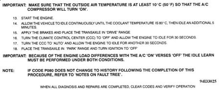

The car will run perfectly for several days then suddenly stall when the acelerator is pressed. No power. Sometimes the odor of raw gas is present. I can't relate it to running time, engine temp. or weather etc.
The "service engine soon" light is always on.
A code "P080 current" always shows. Idle self learn.
I have substituted the ECU, replaced the MAP (Manifold Absolute Pressure) and the throttle position sensor, none corrected or changed the symptoms.
I used the original proms in the substituted ECU
I accurately used the General Motors "TP sensor/IDLE learn" programming to remove the P080 code from current status to history status, it didn't remove it. They refer to "Notes on Fault Tree" when the code doesn't become a history code. 94I33025

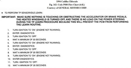

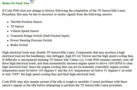

Hi peterrmick, Thank you for the donation. Here are the explanation of the fault tree. Hope it is the one you are refering to.
https://images.2carpros.com/forum/automotive_pictures/192750_FaultTree94Elcorado_1.jpg
https://images.2carpros.com/forum/automotive_pictures/192750_CodeP080a1_1.jpg
https://images.2carpros.com/forum/automotive_pictures/192750_CodeP080a2_1.jpg

With respect to the 4.9L engine and Northstar (4.6L) engine, the P080 code has different meanings.
For the Northstar, the Factory Manual states the P080 code means there is a "TP SENSOR IDLE LEARN NOT COMPLETE" problem.
The P080 code in the 4.9L engine refers to 'FUEL SYSTEM RICH'
INFORMATION RELATED TO P080 CODE AND 4.9L ENGINE:
In the 4.9L engine, the purpose of the P080 code is to detect a rich condition in the fuel injection system, or continuous evaporative (EVAP) control canister purge.
1. A rich fuel injection system can be caused by:
A. Leaking injector
B. Faulty fuel pressure regulator
C. Restricted fuel return line
2. Continuous evaporative emission (EVA) control canister purge can be caused by:
A. A leaking purge valve
B. Purge solenoid, circuit or PCM

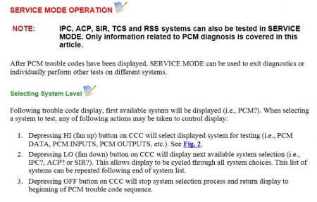

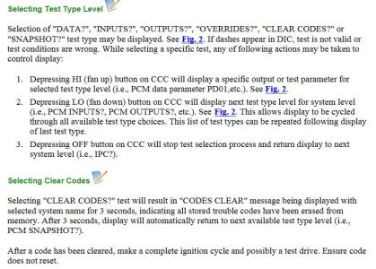

Hi Pete, If the throttle butterfly is sticking, you would feel it on the accelerator. Here are the procedures for clearing the codes. Without clearing the codes, the PCM might not react correctly.
https://images.2carpros.com/forum/automotive_pictures/192750_ServiceModeOperation94Eldorado01_1.jpg
https://images.2carpros.com/forum/automotive_pictures/192750_ServiceModeOperation94Eldorado02_1.jpg
The service mode chart is too small to be printed legibly and if you require it, let me know what emial to send to.

I hope the diagram helps (e-mail is peterrmick@comcast.net *note the 2 r's), I assume that is FIG2 in your response?. Is the Michaels1 repair manual a worth while investment? (assuming I get back on the road). Thank you Pete
