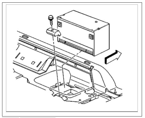

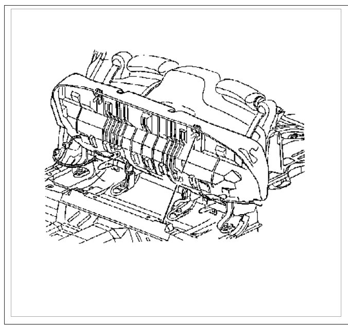

I am trying to lift rear seat up and out to gain access to Battery. No matter how hard I pull push or tug, the seat will not release so I can pull it up. Is there a tool I can use to force it up or can I reach any clips or fasteners that are holding it down. I have got into the back and tried pulling up on both sides together. It will not move, just the top cover comes up a few inches.

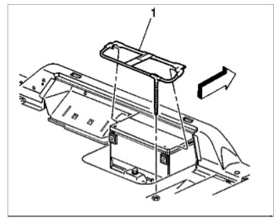

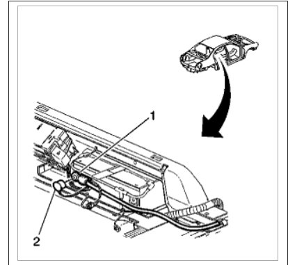

You must lift the rear seat cushion here is a guide to help you see what you are in for doing the job.
https://www.2carpros.com/articles/how-to-replace-a-car-battery
Here are diagrams to help you see what it will be like for your car
Cheers

Lift up the rear seat cushion, the battery is on the rh side. If you have rear seat heaters, there is a connector to the cushion, disconnect and you can remove the cushion. A power saver is not necessary, you will have to set the clock, and perhaps radio station presets. It is not a special battery, But I am not really fond of Walmart batteries. A batteries life can directly depend on its shelf life(turnover), and maintenance while on the shelf.
