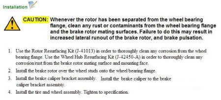

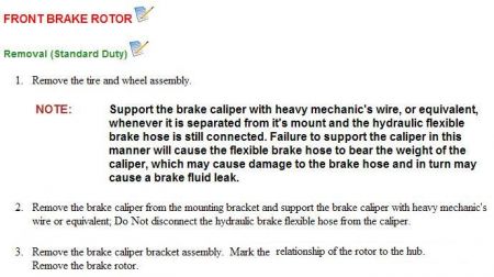

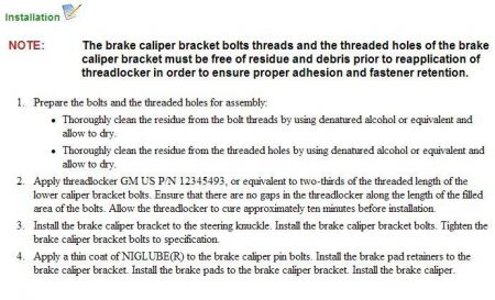

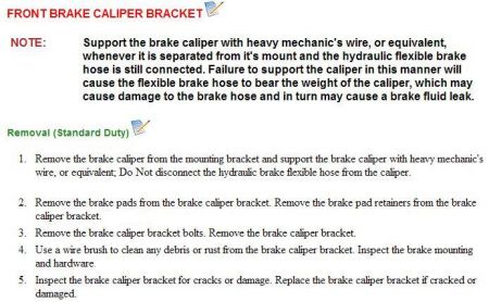

Would it be simple for me to replace my front rotors with internet purchase of high temperature rotors? (I am experienced at changing disc brake pads myself.) After starting up and braking down long boulevards for several miles and several stops over the past 4 years, I now get slight wheel shimmying along with jerky braking after the brakes get hot.
Jan 30, 2010 at 2:30 PM
BLUELIGHTNIN6
  • 16,542 POSTS
this will help you along the way..
