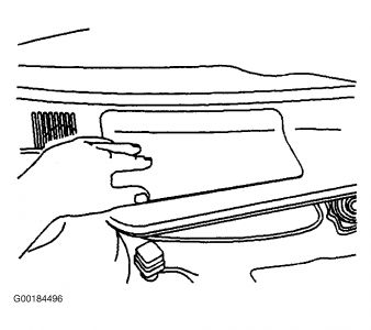

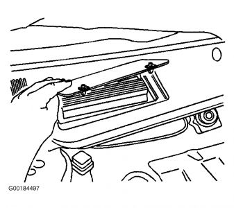

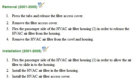

How do you change a cabin air filter in this car? Also where is it located at I think I know but I am not sure.
Wednesday, May 19th, 2010 AT 3:14 PM
BLUELIGHTNIN6
MECHANIC
16,542 POSTS
Should have access panel on cowl area below windshield on outside..
