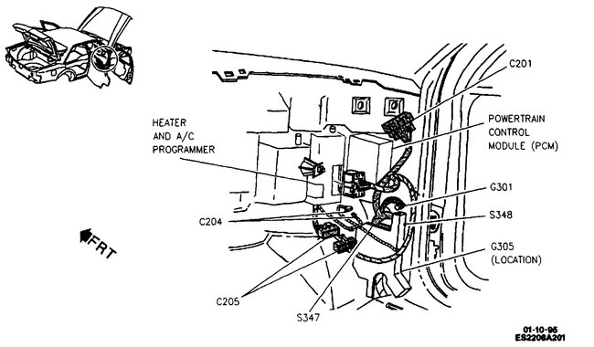

where is the Engine Control Module located on a 1995 sedan deville w/ 4.9L engine?
Apr 17, 2008 at 1:29 PM
BMRFIXIT
  • 19,053 POSTS
right side under the glove box and to the right. Here are the diagrams on what it looks like and the location under the dash on the right side. Check out the images (Below). Please let us know what happens.

i had no idea they change its location mitchell on demand and all data both agree with me its under the right side of the dash mitchell had no clear picture so this is from all-data let me know if i need to update my books !

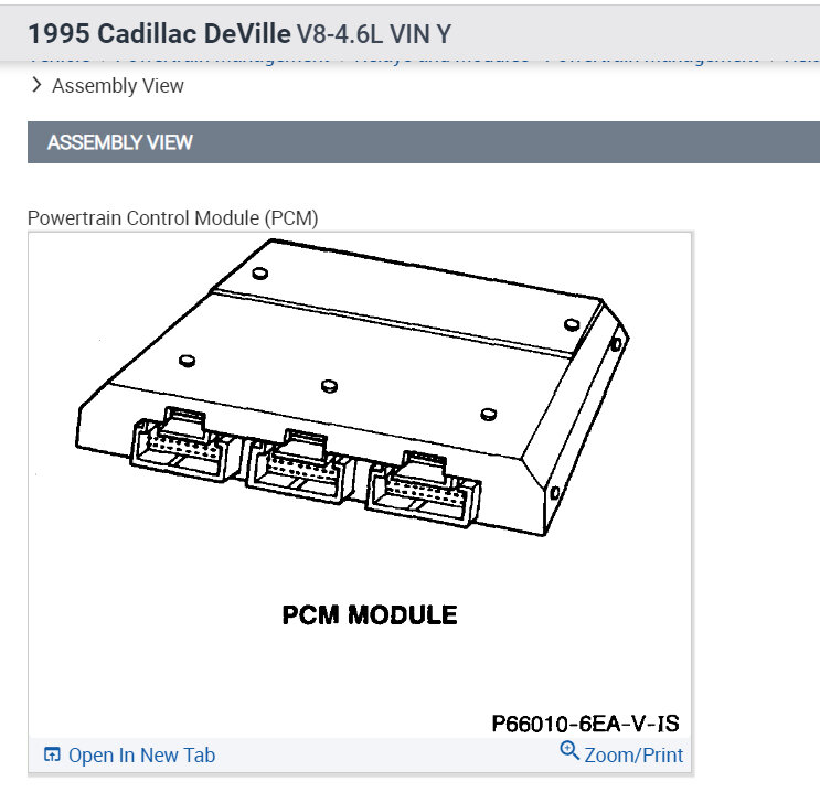

The PCM is behind the glove box, up in the corner. Three different size connectors, I think just a 10mm nut on a stud and bracket will allow it to be removed.

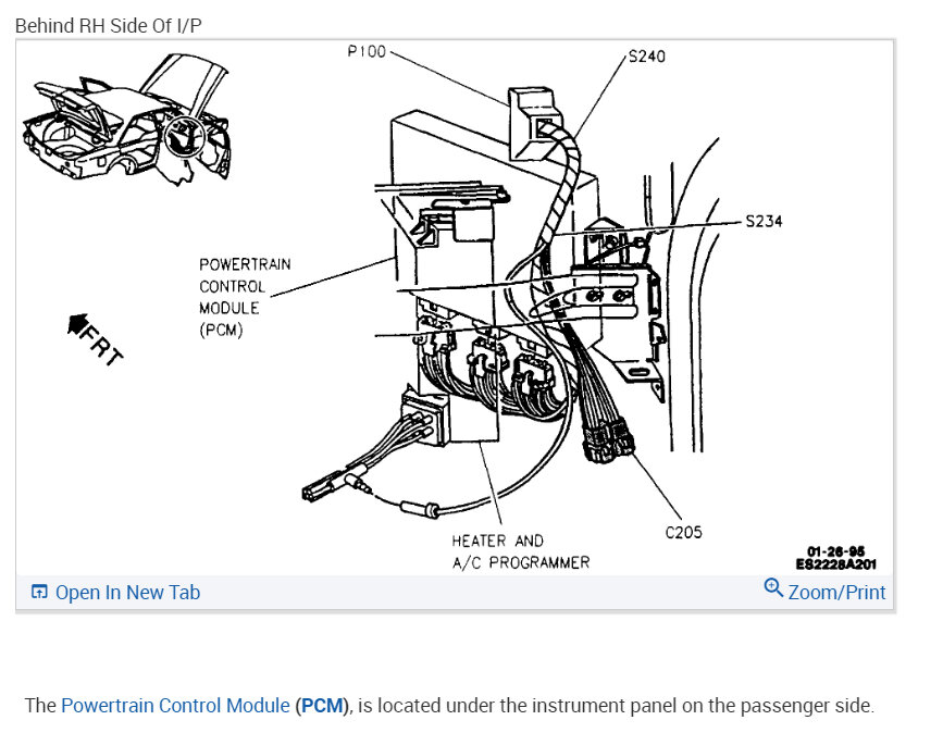

You have a 4.1 engine, not a 401.
It's located behind RH Side Of I/P, Near Shroud

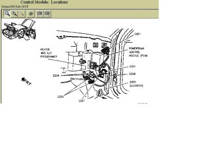

CADIEMAN
  • 3,544 POSTS
the ecm is under the r/side dash under the lower panel on the firewall.why are you replacing it????
