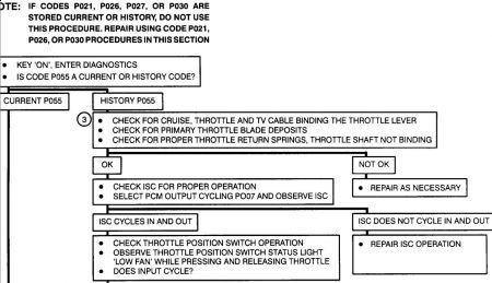

what do these mean.
current code po30
history codes po31, po39,po52,po55,po98.
Help would be great.

4.9 or 4.6 makes no difference:
P030 ISC RPM out of range
P031 shorted map sensor
P039 TCC engagement problem
P052 keep alive memory reset(can happen with dead/discon. battery)
P055 Closed throttle rpm out of range
P098 High RPM P/N to D/R shift under ISC(this code applies to 4.9l only)

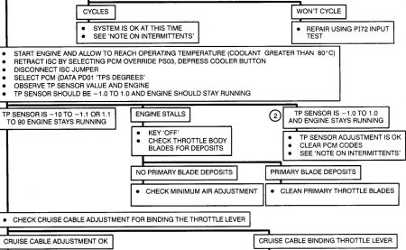

P030 current and P055 history, instruction is to repair P055 first clear codes, then see if any reset, here's the t/s flowchart for P055:
https://images.2carpros.com/forum/automotive_pictures/62217_55a_1.jpg
https://images.2carpros.com/forum/automotive_pictures/62217_55b_1.jpg
https://images.2carpros.com/forum/automotive_pictures/62217_55c_1.jpg
