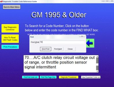

After clearing fault codes, the only thing that shows is 0.7.0. What does it mean? Does it mean fault code 70? Or just that everything is ok? I think I read somewhere that 0.7.0 is the end of the systems check or something like that.
However it IS popping from the exhaust while trying to start (cranks but won't start). Sounds like timiing. I dread it!!

Here'sa what I came up with for the code, Did you check the plugs for gas fouling after the pump problem? Gas in oil? Plug wires to proper plugs?
https://images.2carpros.com/forum/automotive_pictures/62217_70_1.jpg
12 is the code you were thinking about...
