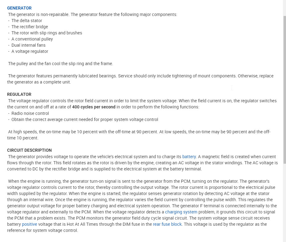

If there are no codes then I can only assume there is an issue with the PCM. The voltage regulator is in the alternator but the voltage is sent to the PCM and I am thinking the PCM is causing the voltage issue.

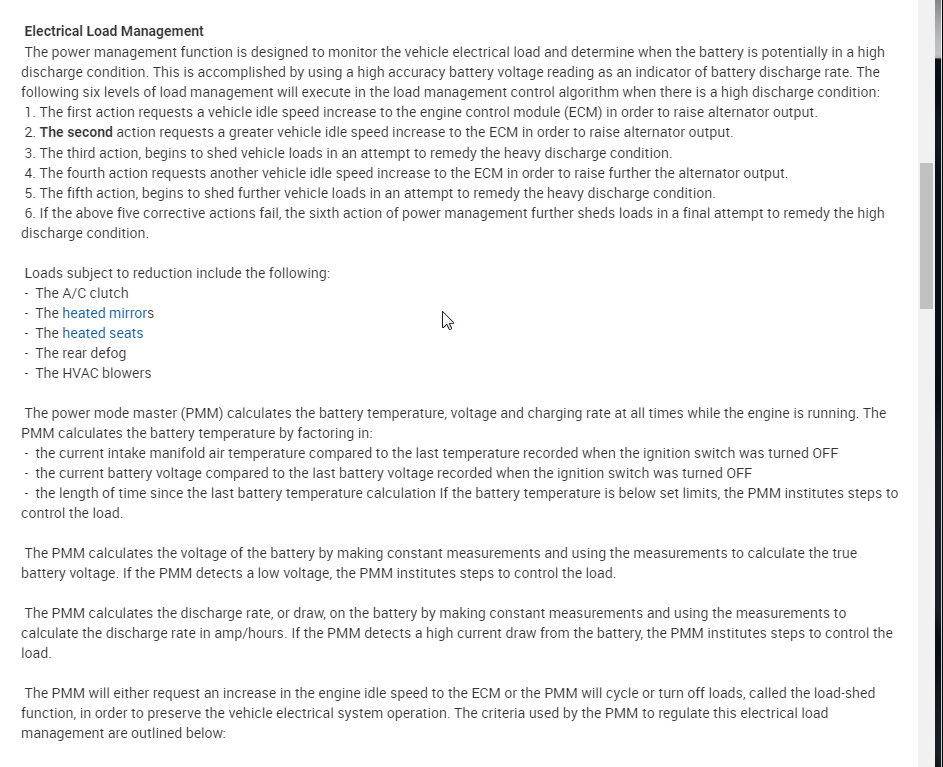

The reason I suspect the ECM/PCM is this has the ability to shut the vehicle off and cause the issue you are seeing. It isn't supposed to shut the vehicle off but if it looses power or the crank signal it will think the engine just shut off and turn everything else off. It is supposed to perform what is called load management but this is not happening.

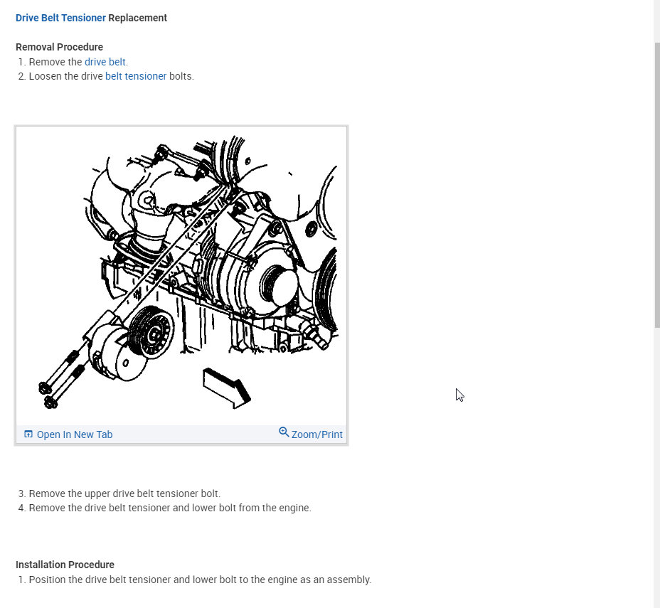

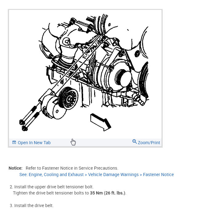

Okay. I am thinking this is one of two issues. First the easier of the two is the belt tensioner. I asked a GM dealer if they heard of this and they have. Apparently this issue is not that uncommon. They said that when the engine is under load coming to a stop and the tensioner is not holding proper tension on the belt that the voltage drops and once it reaches about 12.5 volts while running the PCM shuts the engine off.
