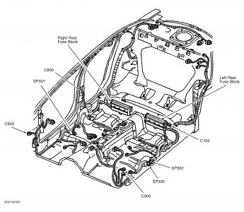

Right rear fuse block is located in the passenger compartment, under the right side of the rear seat. Left rear fuse block is located in the passenger compartment, under the left side of the rear seat
https://images.2carpros.com/forum/automotive_pictures/99387_5239bl_8.jpg
