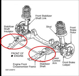

1999 Cadillac Catera Two Wheel Drive Automatic
What is the easiest way to take out and replace the sway bar? Already have the rotors and control arms off.
Mar 7, 2009 at 9:04 AM
IMPALASS
  • 3,112 POSTS
Hello - Well my friend, looks like you are almost there. Just removed the 4 bolts where the red circles are and you are there. I would replace the rubber insulators while you have them off. Some have grease fittings. If not put a tad there.
https://images.2carpros.com/forum/automotive_pictures/248015_Cadillac_Sway_Bar_with_Circles_1.jpg
Does this help you out?
