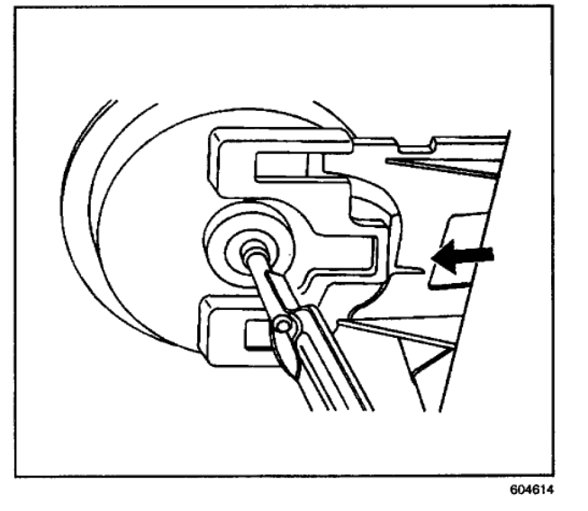

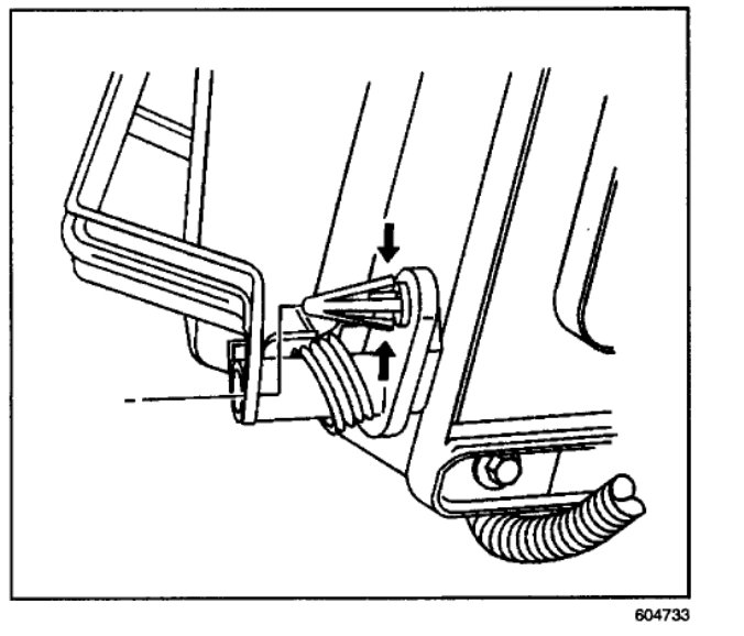

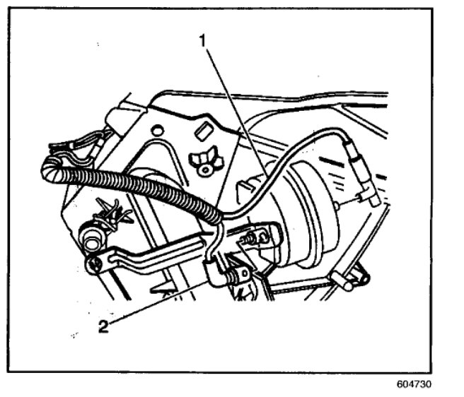

There is no filter in the system. They did away with that for some reason. There is a mode door actuator that goes out which can cause the air flow to be little or not at all.
Here is a guide and some diagrams (below) to help you get the problem fixed:
Your is vacuum operated so check the vacuum line (small) headed from the firewall to the engine. This line supplies vacuum to the system. You check check for vacuum at the servo as well.
Please let us know what happens and upload pictures or videos of the problem.
