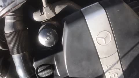

Hey I bought a this car secondhand from someone and have been working on it. I have replaced the filters (air,oil, transmission) and put new ignition coils in as well. It's in limp mode currently and it idles very hard and makes a knocking like sound from the tappets cover or in the valve cover area making it sound like a diesel engine. Any suggestions or ideas?

First, is it possible for you to record and upload the sound so I can hear it? Also, have you checked oil pressure and scanned for diagnostic trouble codes?

Lol. so I will send a video tomorrow when i can get in front of the car. But i'm unable to scan because the scan tool turns on when plugged in but wont connect.

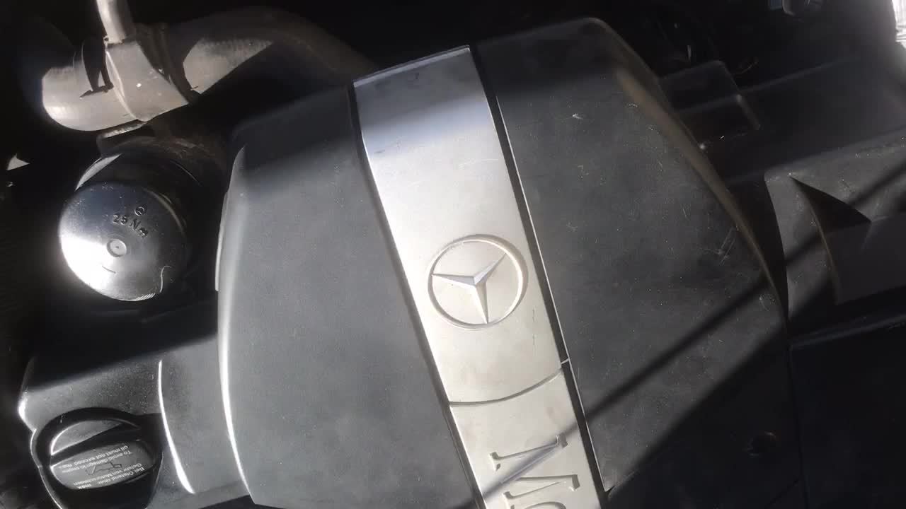

Here is the video of the noise.

I do hear a lifter noise. It can be caused by low oil pressure or a bad lifter. Is that what you are referring to?

The ticking is a lifter. Let me know what you find or if you have other questions.
