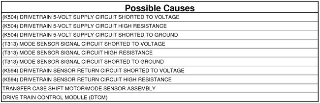

My truck keeps showing 4WD service light. It comes on sometimes when I turn the truck on.
The mechanic pulled C1480 code and said that it is either the sensor or the wiring.
First question is that I do not know which sensor he was talking about.
Second; he disconnected and cleaned and put some silicone stuff on to prevent it.
The light came back on and he said it was the transfer case motor and the e7 (female and male) part that he would like to change.
Any thoughts? And how I can fix this before the snow starts?
Oct 29, 2018 at 11:11 AM
  • 110,244 POSTS
C1480-TRANSFER CASE RANGE DIGITAL POSITION SENSOR PERFORMANCE
What does that mean. Basically, there is a range position sensor which is either receiving too little, too much power or voltage fluctuation. The result is the check engine light and failing 4wd.
For me to simply say replace the sensor isn't a good idea because there are several things which can cause this code to become active. See pic 1
Now, to determine which of the things in pic 1 is the cause, one must complete a circuit test. It requires diagnostic equipment to perform. I will provide the flow chart so you can see what will need done. It is very extensive. If you decide to try the switch itself, picture 2 shows its location.

I hope this is helpful. Let me know if you have other questions.

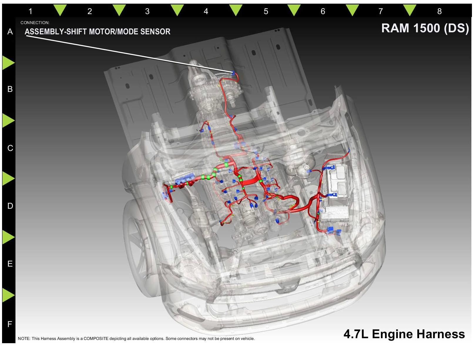

DANIEL KIM
Thank you for your quick response, Joe.
What is the sensor called? Or picture of it? Or part number?
Oct 29, 2018 at 10:11 PM
  • 110,244 POSTS
Hi again. The sensor is the transfer case range position sensor. If you look at picture 2 above, it indicates its location. It is mounted on the transfer case.
