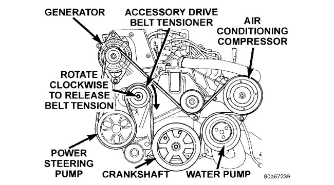

It's not that don't like the answer.. I know the length of the belt and have the new belt to bypass the compressor. I need the diagram bypassing the compressor.
Jan 3, 2020 at 3:10 PM
SCGRANTURISMO
  • 4,897 POSTS

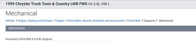

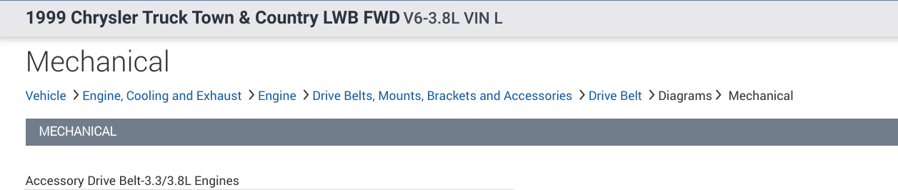

I have included the diagram for your vehicle's drive belt in the diagrams down below. It looks like you are going to have an A/C bypass, or idler pulley either manufactured or purchase one for your vehicle because you can not bypass the A/C compressor on your vehicle unless you switch water pump pulley to a ribbed pulley. I hope this helps.
