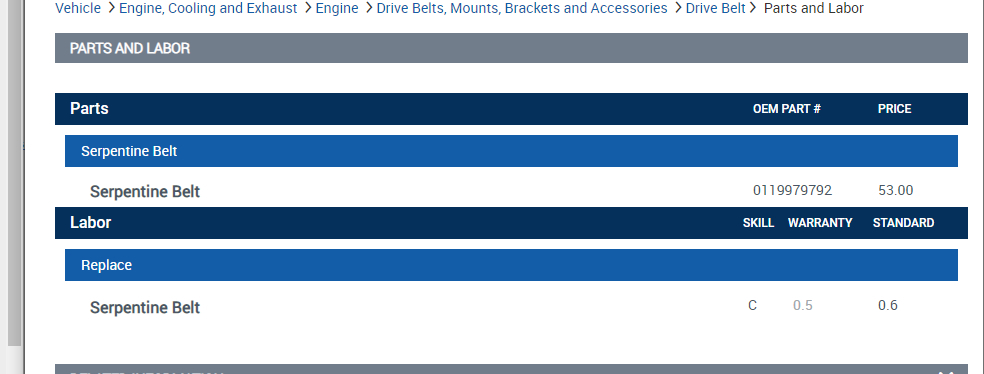

My a/C compressor seized up and I wanted to know what size belt could I use to bypass the A/C compressor?
Dec 9, 2017 at 6:19 AM
Unfortunately they don't list a belt with no A/C so your options are limited. First you can run a string around the pulleys less the compressor and find a belt that matches that custom size.

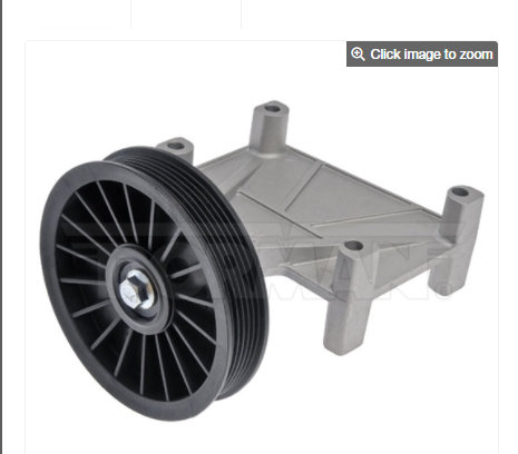

The other option is to install a bypass pulley and just use the stock belt.

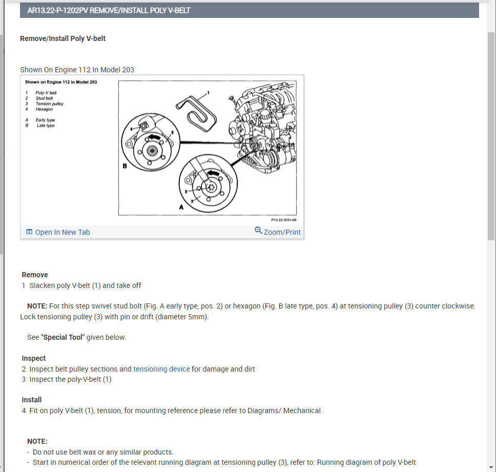

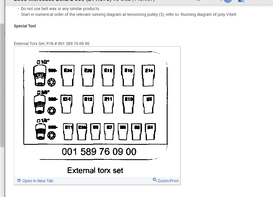

Here is a guide that will help with removing the belt and reinstalling it:
Below you will find the process from the manual and a picture of a bypass pulley.
