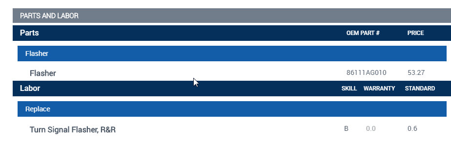

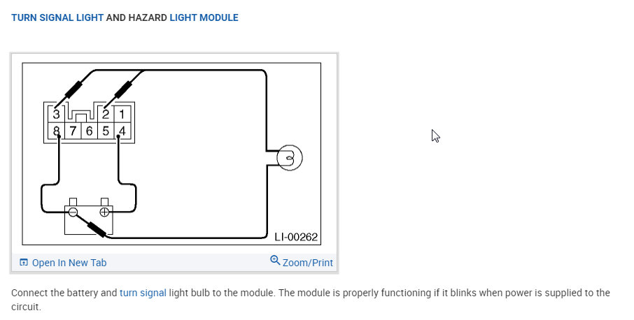

This is most likely the flasher. Which is basically a relay. The clicking you are hearing is it going on and off very rapidly. This is either because the relay is failed or the battery is too low.
I would recommend just unhooking the battery for overnight and then testing and charging the battery. If it stops when the battery is charged or replaced then the flasher is fine. If not, it needs to be replaced.
Let me know if you have questions. Thanks
