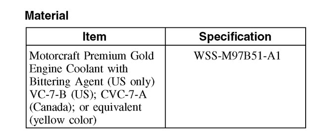

Material
pic 2

CAUTION: The engine cooling system is filled with Motorcraft Premium Gold Engine Coolant. Mixing coolant types degrades the corrosion protection of Motorcraft Premium Gold Engine Coolant.

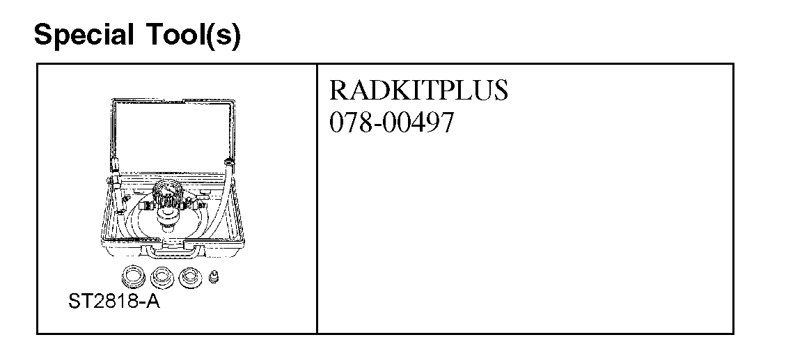

Filling and Bleeding with RADKITPLUS
1. Using the special tool, install the RADKITPLUS and follow the manufacturer's instructions to fill and bleed the cooling system.

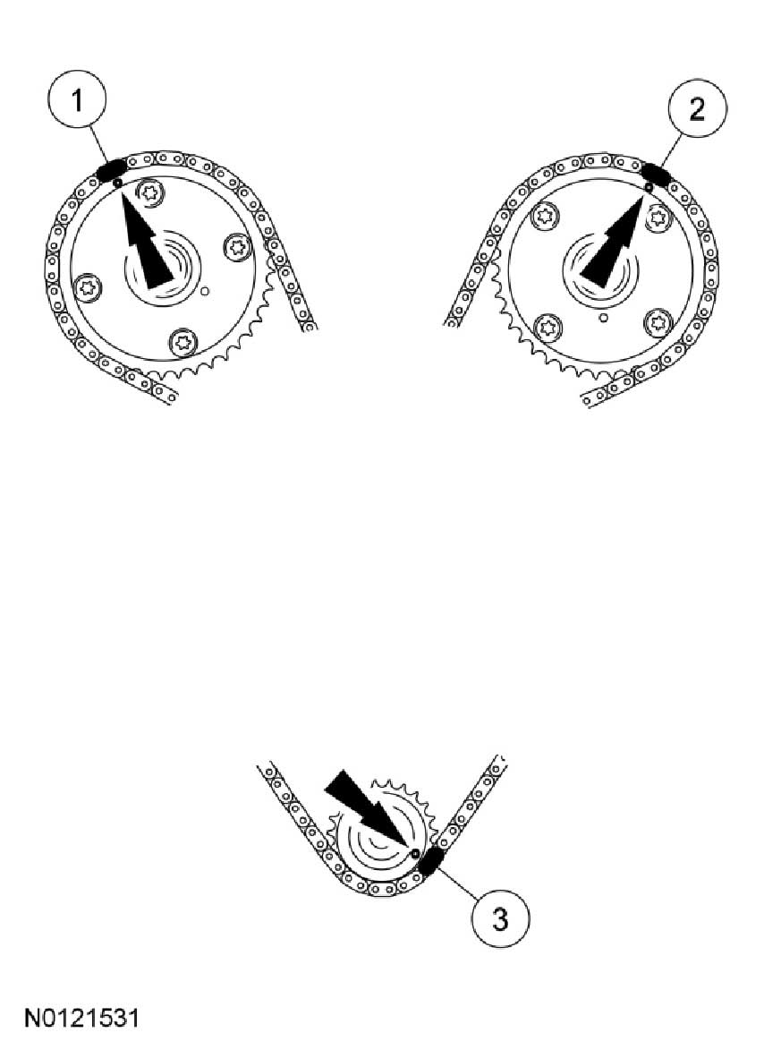

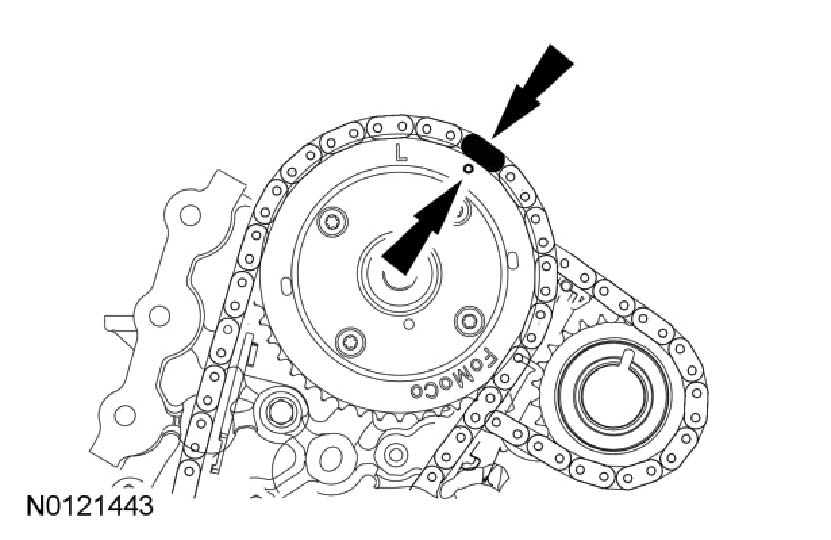

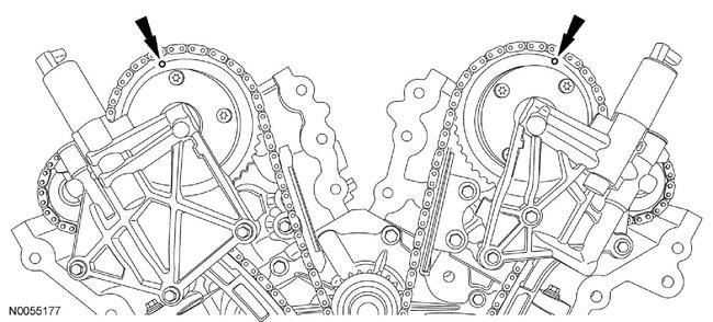

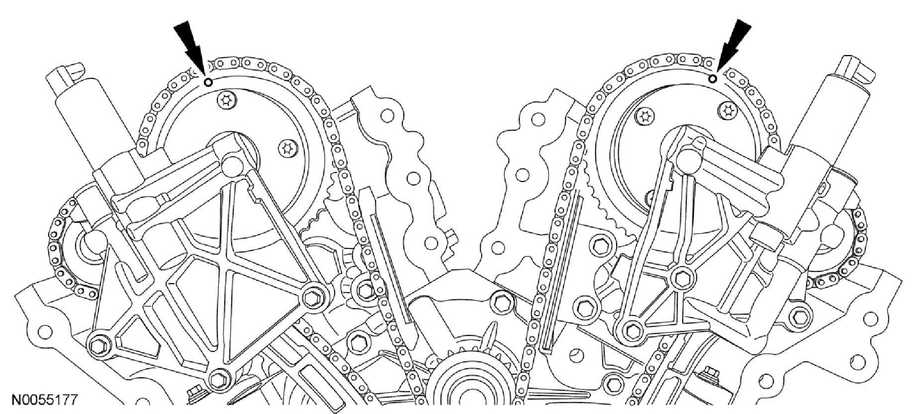

5. Rotate the crankshaft clockwise and align the timing marks on the Variable Camshaft Timing (VCT) assemblies as shown.
pic 4

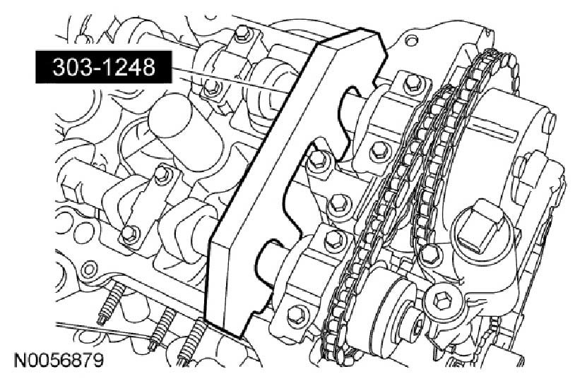

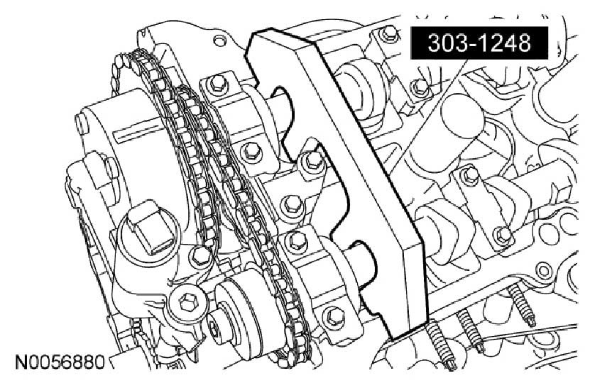

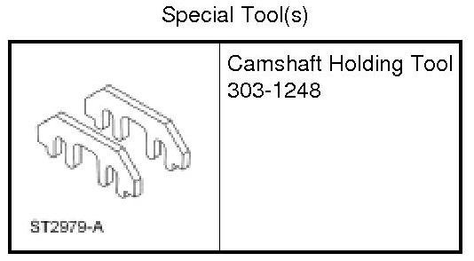

6. NOTE: The Camshaft Holding Tool will hold the camshafts in the Top Dead Center (TDC) position.
Install the Camshaft Holding Tool onto the flats of the LH camshafts.
pic 5
7. NOTE: The Camshaft Holding Tool will hold the camshafts in the TDC position.
Install the Camshaft Holding Tool onto the flats of the RH camshafts.

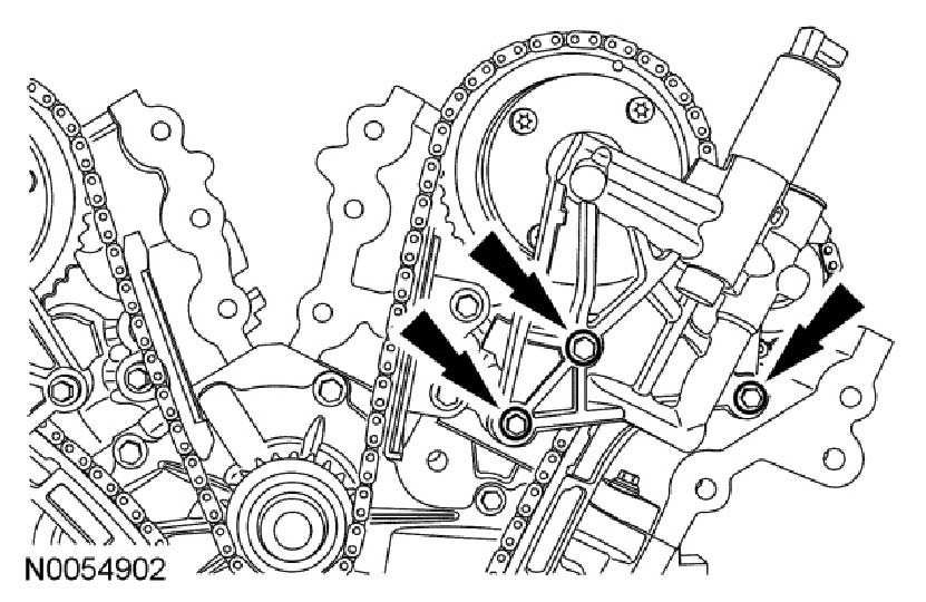

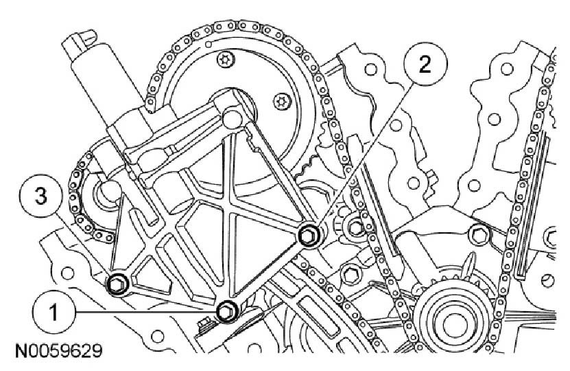

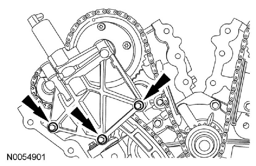

8. Remove the 3 bolts and the RH VCT housing.
pic 7
9. Remove the 3 bolts and the LH VCT housing.

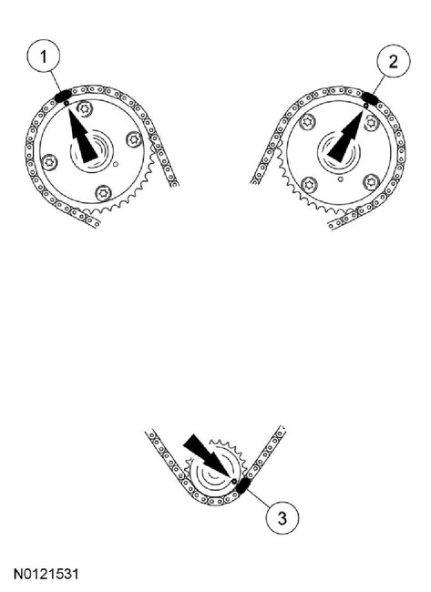

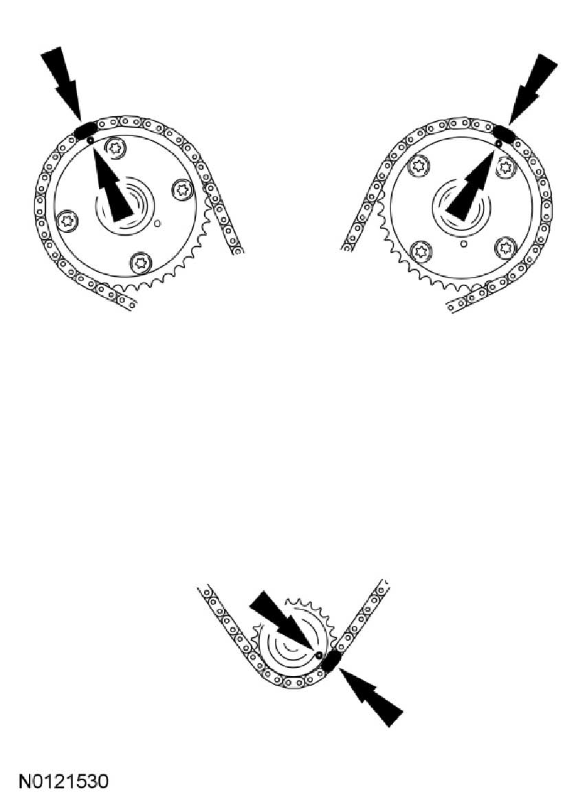

NOTE: The following 3 steps are for primary timing chains when the colored links are not visible.
pic 8

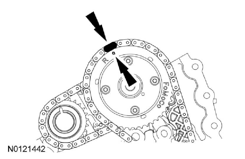

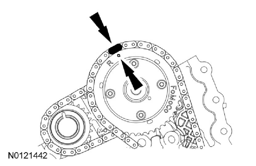

10. Mark the timing chain link that aligns with the timing mark on the RH intake VCT assembly as shown.
pic 9
11. Mark the timing chain link that aligns with the timing mark on the LH intake VCT assembly as shown.
pic 10

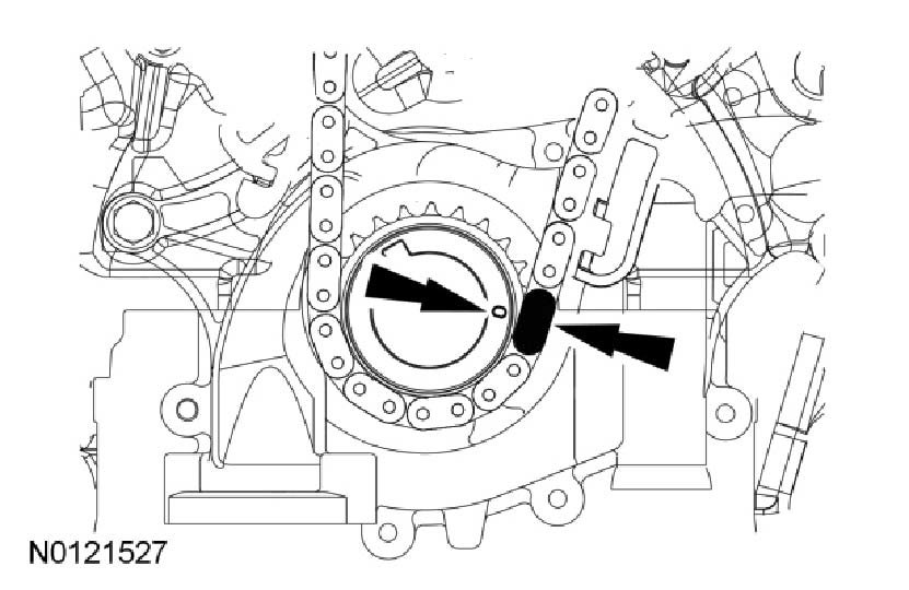

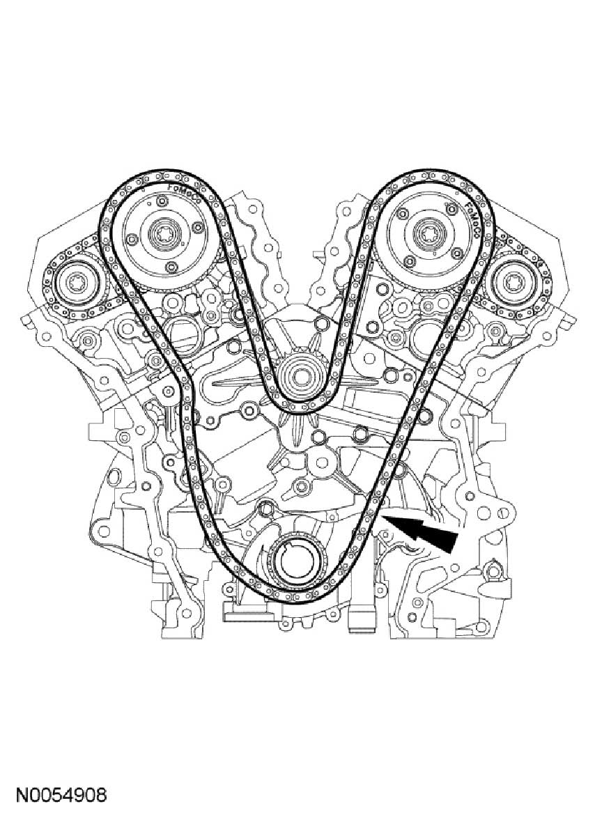

12. Mark the timing chain link that aligns with the timing mark on the crankshaft sprocket as shown.
pic 11

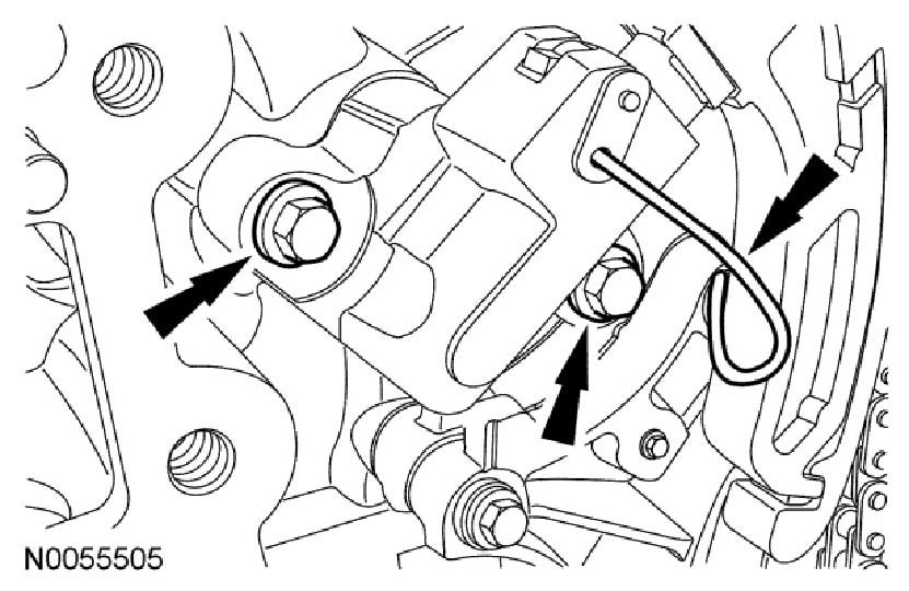

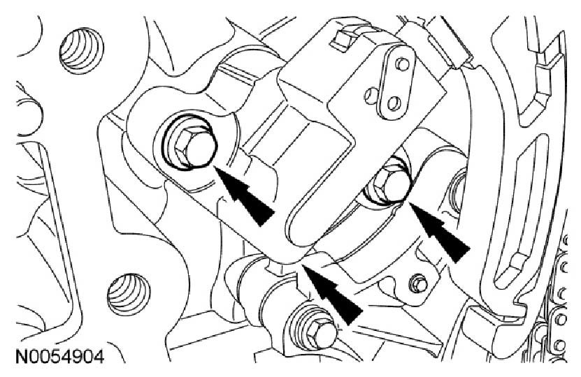

13. Remove the 2 bolts and the primary timing chain tensioner.
pic 12

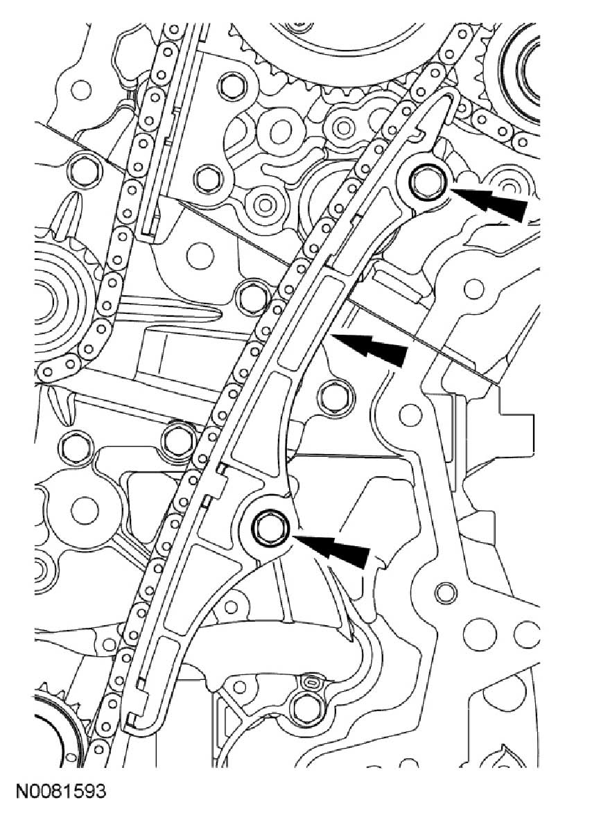

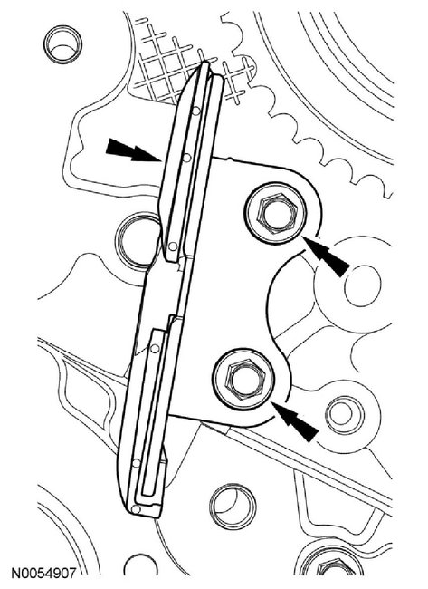

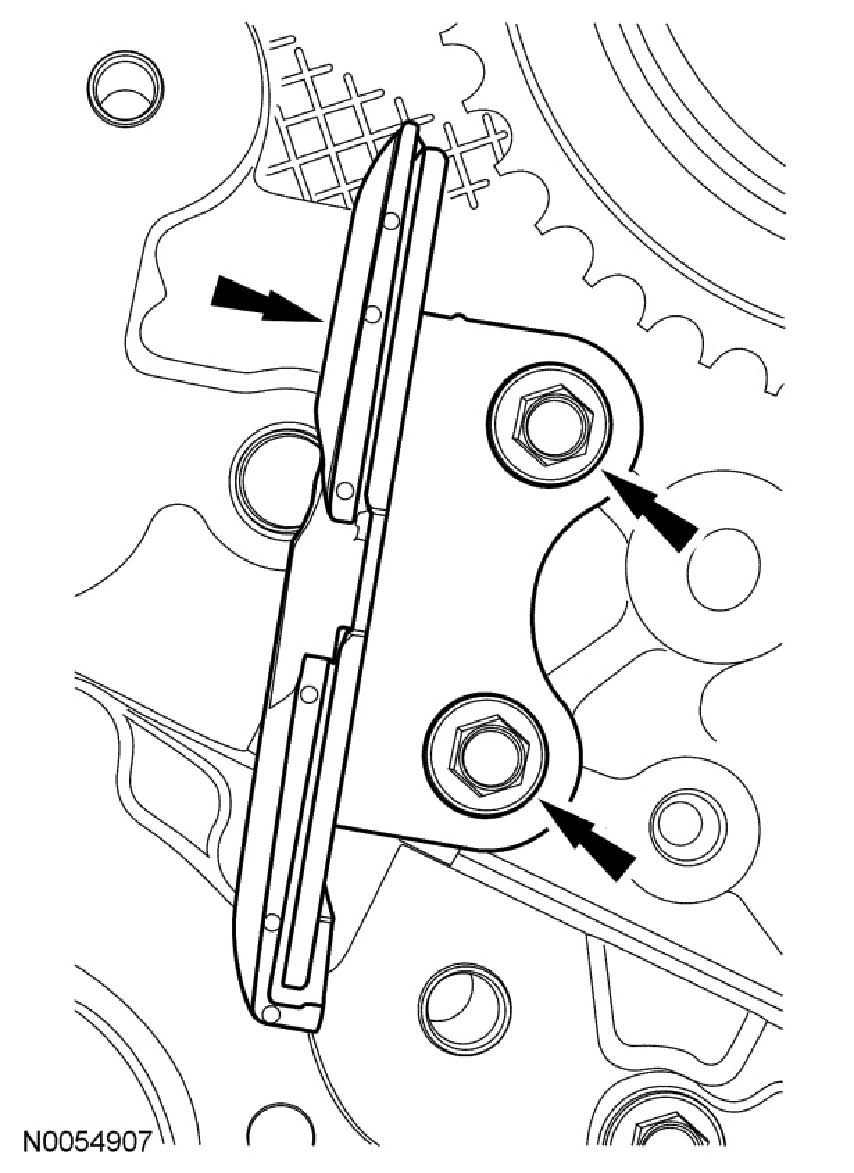

15. Remove the 2 bolts and the lower LH primary timing chain guide.
pic 14
16. Remove the primary timing chain.

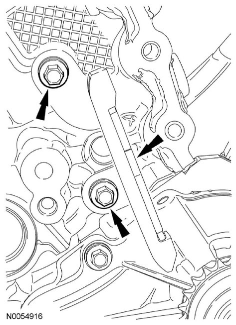

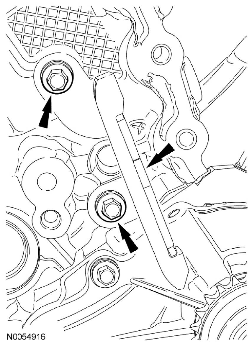

17. Remove the 2 bolts and the upper LH primary timing chain guide.
pic 16

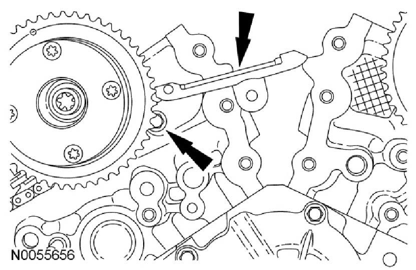

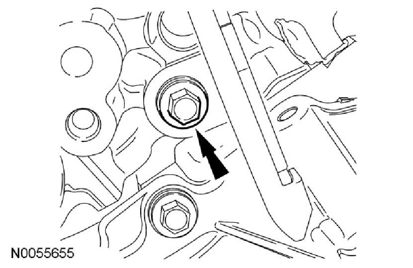

18. Remove the RH primary timing chain guide lower bolt.
pic 17

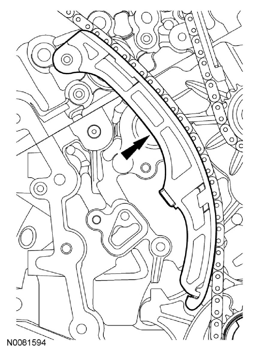

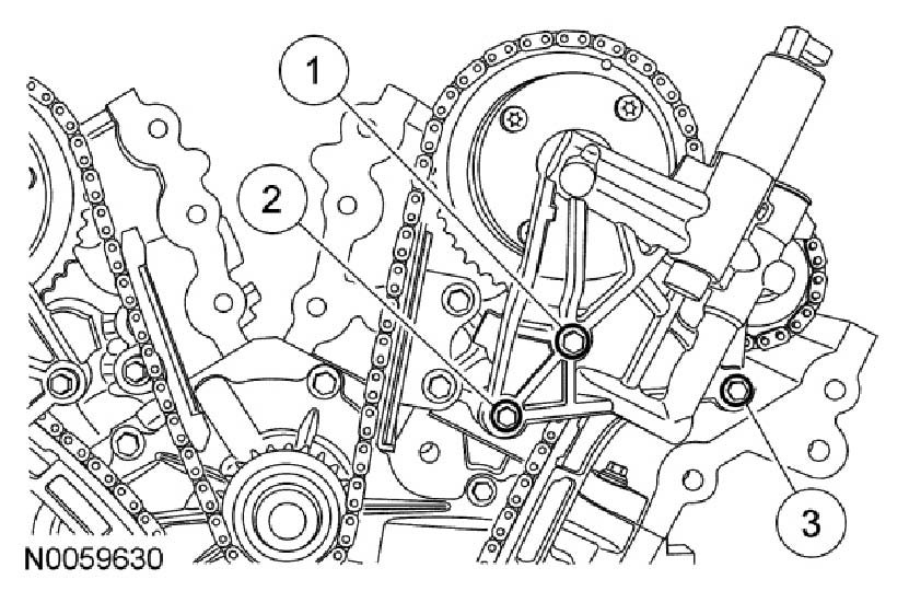

19. NOTE: The RH primary timing chain guide must be repositioned to allow the coolant pump to be removed.
Loosen the RH primary timing chain guide upper bolt.
- Rotate the guide and tighten the bolt.

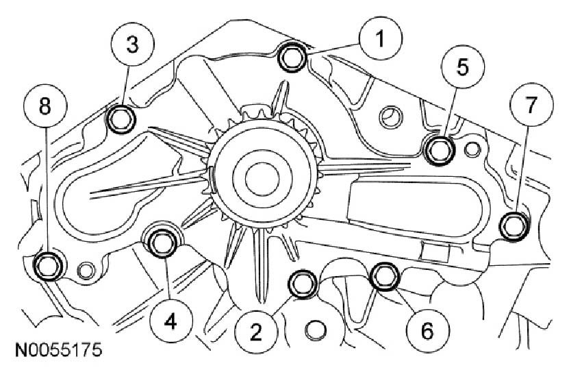

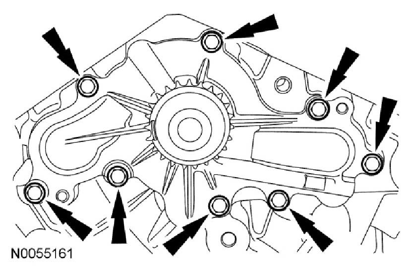

21. Remove the 8 bolts and the coolant pump.

Install the coolant pump and the 8 bolts.
- Tighten in the sequence shown to 10 Nm (89 lb-in).

4. Loosen the RH primary timing chain guide upper bolt.
- Position the RH primary timing chain guide and install the lower bolt.
- Tighten the 2 bolts to 10 Nm (89 lb-in).

5. Install the primary timing chain with the colored links aligned with the timing marks on the VCT assemblies and the crankshaft sprocket.

6. Install the upper LH primary timing chain guide and the 2 bolts.
- Tighten to 10 Nm (89 lb-in).

7. Install the lower LH primary timing chain guide and the 2 bolts.

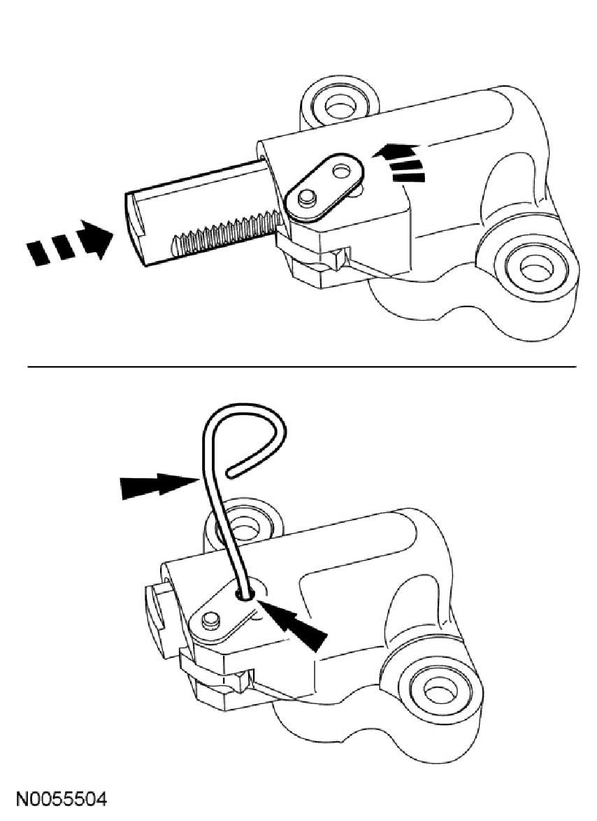

9. Reset the primary timing chain tensioner.
- Rotate the lever counterclockwise.
- Using a soft-jawed vise, compress the plunger.
- Align the hole in the lever with the hole in the tensioner housing.
- Install a suitable lock pin.
pic 26
10. NOTE: It may be necessary to rotate the crankshaft slightly to remove slack from the timing chain and install the tensioner.
Install the primary tensioner and the 2 bolts.
- Remove the lock pin.

11. As a post-check, verify correct alignment of all timing marks.
- There are 38 links in between the RH intake VCT assembly colored link (1) and the LH intake VCT assembly colored link (2).
- There are 27 links in between LH intake VCT assembly colored link (2) and the crankshaft sprocket link (3).

Install the LH VCT housing and the 3 bolts.
pic 30
14. NOTICE: Make sure the dowels on the Variable Camshaft Timing (VCT) housing are fully engaged in the cylinder head prior to tightening the bolts. Failure to follow this process will result in severe engine damage.
Install the RH VCT housing and the 3 bolts.
