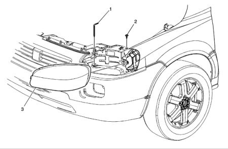

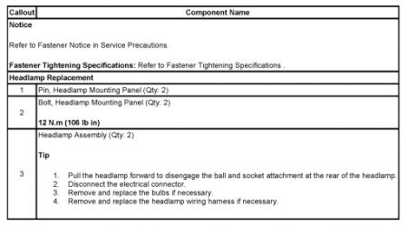

How do you rmove headlamp assembly. It seems that the assembly needs to be removed to replace bulbs and to get access to replace turn signal bulbs as well.
Thanks in advance.
Oct 9, 2008 at 7:15 AM
IMPALASS
  • 3,112 POSTS
Hello - it is really pretty easy compared to many models so you lucked out. I have attached the way. Hope this helps......good luck
