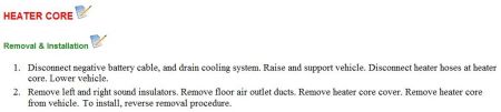

I need instructions on how to change a heater core in this type of car. Thank you.

You must start by disconnecting the battery to avoid electrical problems when doing the job. Here is a guide that will give you an idea of what you are in for.
https://www.2carpros.com/articles/replace-heater-core

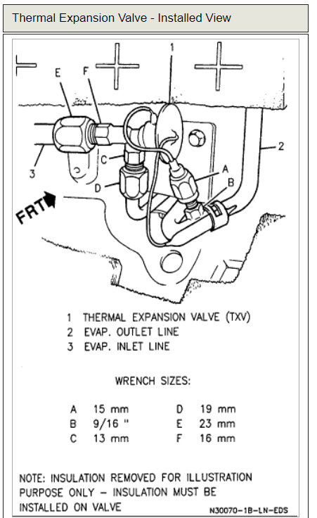

You will need to vacuum down and recharge the air conditioner system here is a guide for that as well.

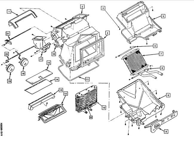

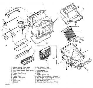

https://www.2carpros.com/forum/automotive_pictures/261618_Noname_2685.jpg
https://www.2carpros.com/forum/automotive_pictures/261618_Graphic_692.jpg
