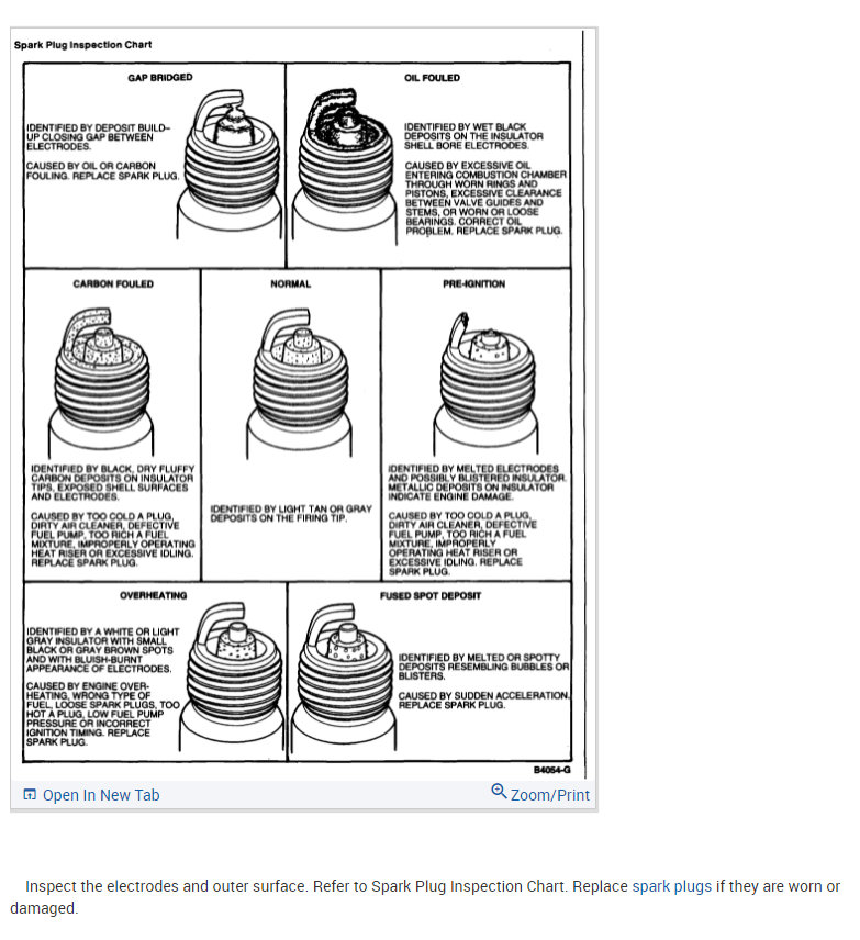

One way to check if there is oil in the combustion chamber is to remove the spark plug and inspect for oil fouling. There will be wet black deposits on the spark plug insulator.
