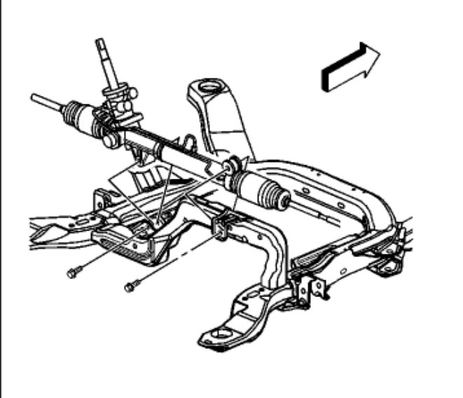

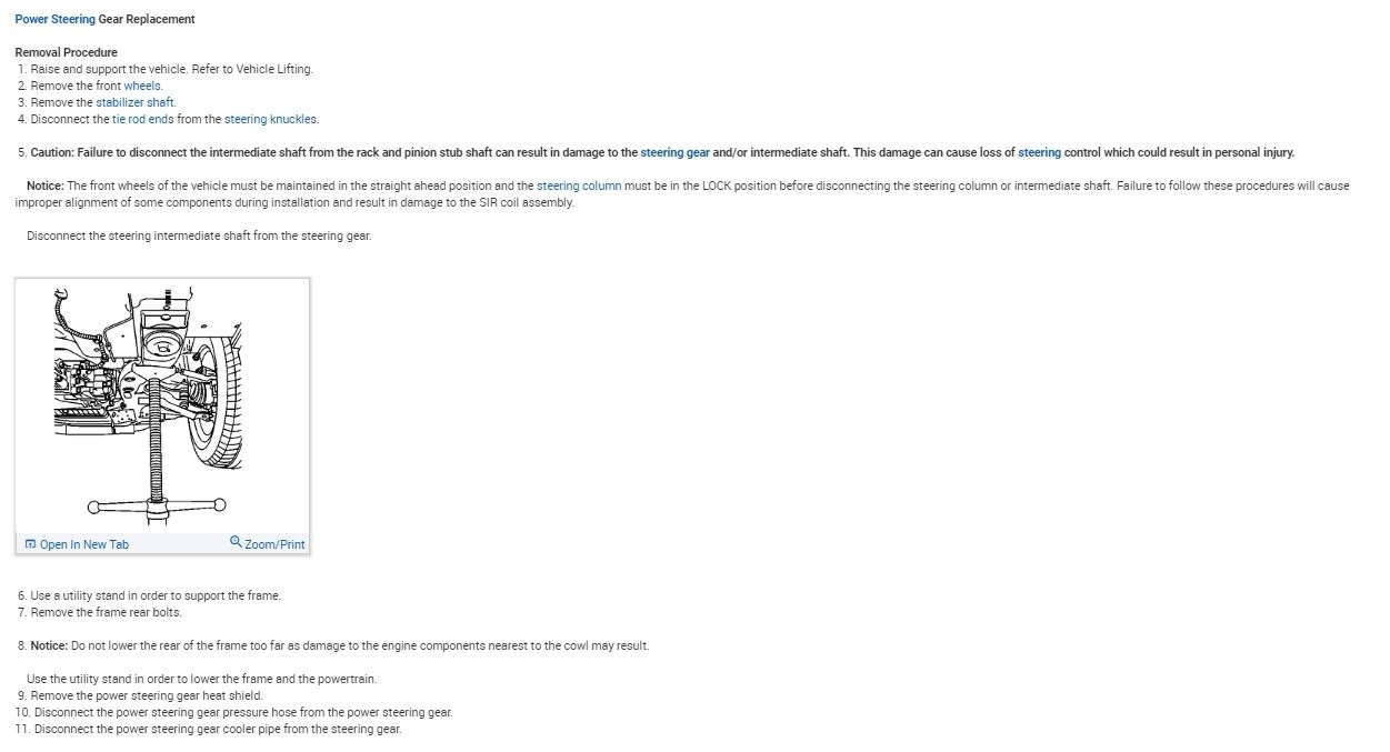

You must jack the car up safely first and remove the battery cable.
Next undo the tie rod ends
https://www.2carpros.com/articles/tie-rod-end-replacement
Here are some stats

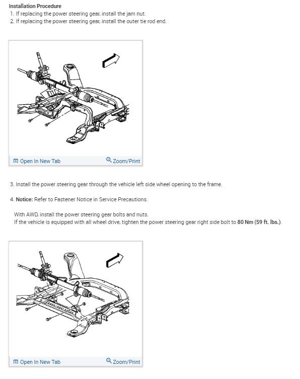

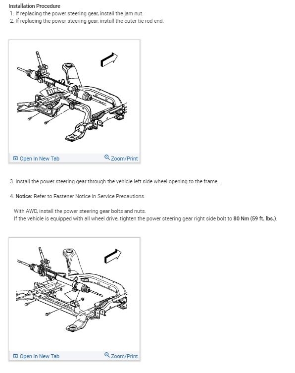

If the vehicle is equipped with all wheel drive, tighten the power steering gear right side bolt to 80 Nm (59 ft. lbs.) .

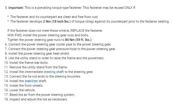

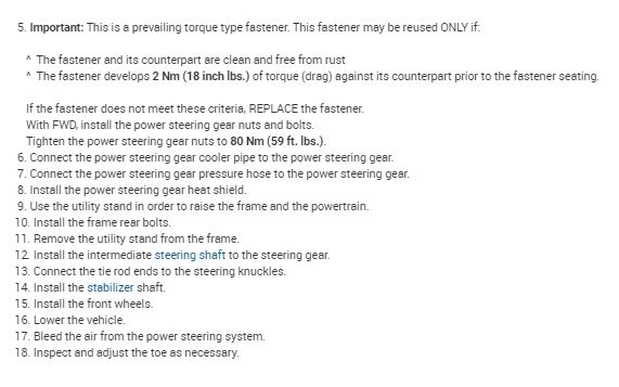

Important: This is a prevailing torque type fastener. This fastener may be reused ONLY if:
The fastener and its counterpart are clean and free from rust
The fastener develops 2 Nm (18 inch lbs.) of torque (drag) against its counterpart prior to the fastener seating.
If the fastener does not meet these criteria, REPLACE the fastener.
With FWD, install the power steering gear nuts and bolts.
Tighten the power steering gear nuts to 80 Nm (59 ft. lbs.)
Bleed the air from the power steering system.
Inspect and adjust the toe as necessary.
I would flush the fluid after completing the job to help clean the pump out.
https://www.2carpros.com/articles/power-steering-fluid-flush

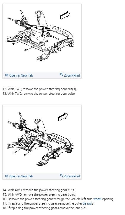

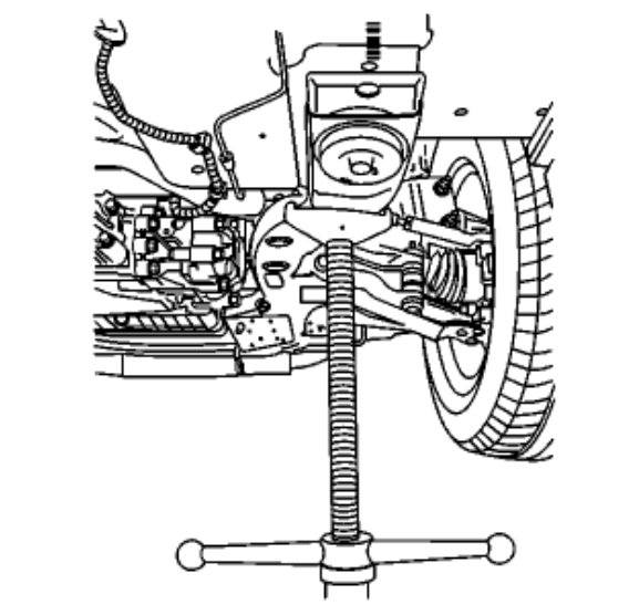

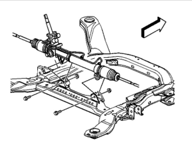

You will have to remove the sub-frame from the front of the vehicle
Check out the diagrams (below) on how to change the steering rack.

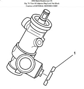

My Rendezvous has about 1/2" to 3/4" steering wheel slack before effecting the steering. Is the gear set adjustable for lash reduction, or must it be replaced? What is the replacement procedure?
Regards,
Ewart Padgett
Nov 5, 2018 at 9:39 AM (Merged)
KHLOW2008
  • 41,814 POSTS
Hi Ewart, HEre are the procedures for adjusting the steering and if there are excessive slack in the steering rack, here are procedures for the adjustment. RACK AND PINION GEAR RACK BEARING PRELOAD ADJUSTMENT - OFF VEHICLE (RACK AND PINION)
https://images.2carpros.com/forum/automotive_pictures/192750_SteeringRack04RendezvousFig79_1.jpg
1 . Loosen the adjuster plug lock nut (1). 2 . Turn the adjuster plug clockwise until the adjuster plug bottoms in the gear assembly. 3 . Turn the adjuster plug back 50 degrees to 70 degrees (approximately one flat). 4 . Install the adjuster plug lock nut (1) to the adjuster plug. 5 . Tighten: Hold the adjuster plug stationary while tightening the adjuster plug lock nut (1) to 68 N.m (50 lb ft).
