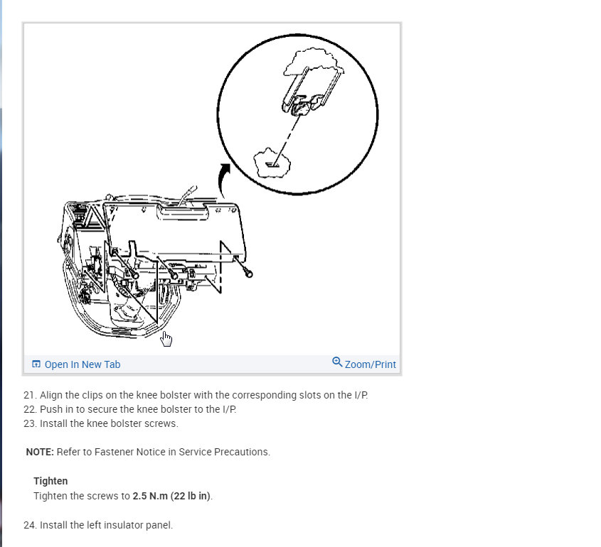

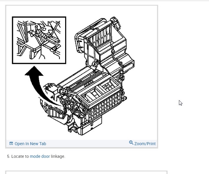

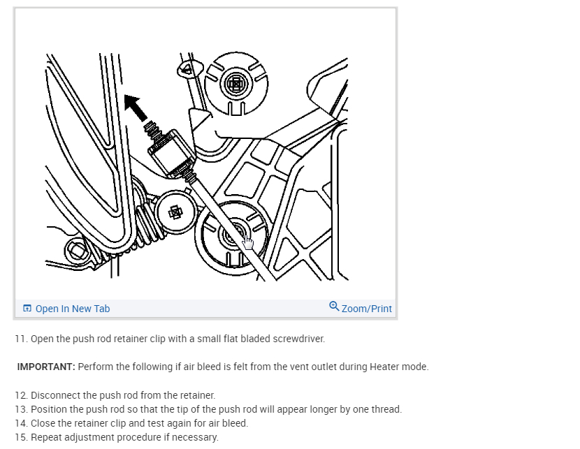

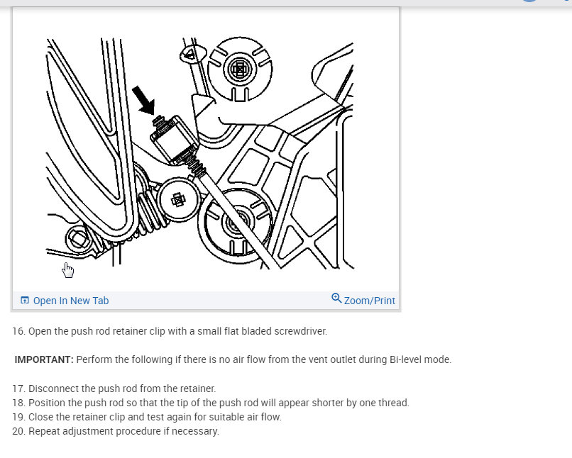

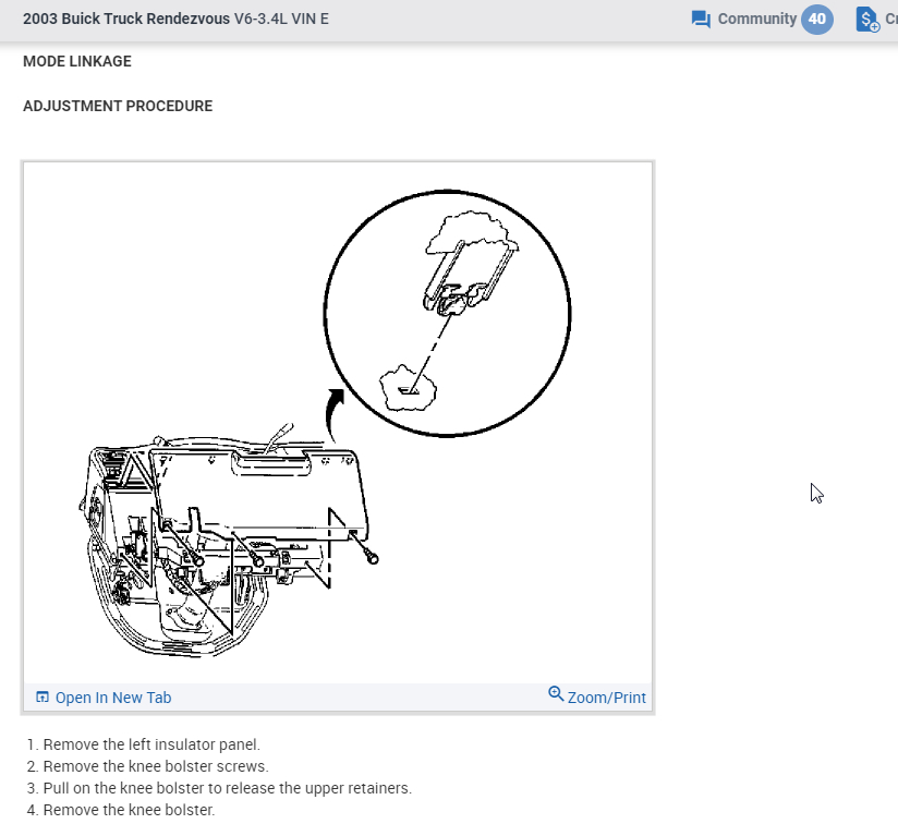

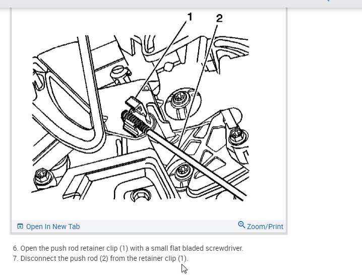

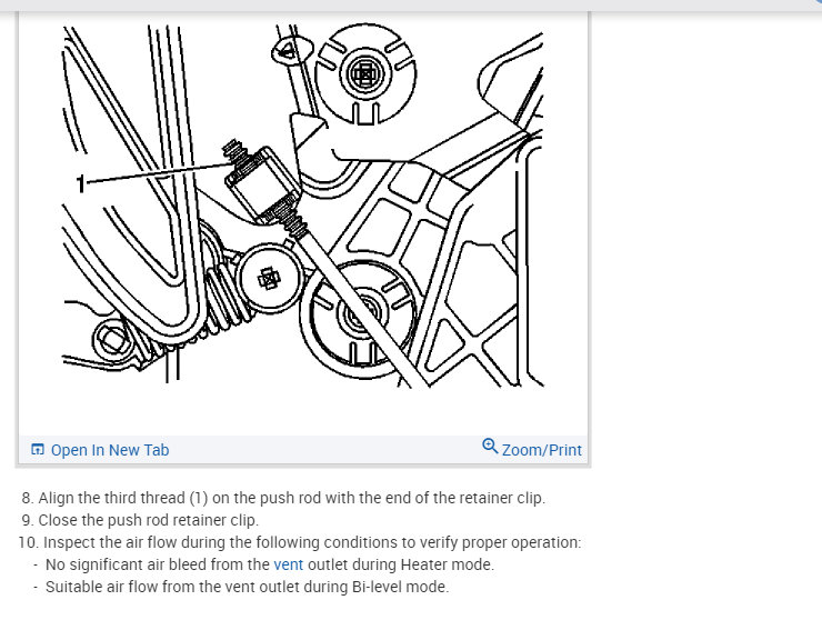

Im having the same issue with my heat. We kept bleeding it while it ran for an hour or more and it eventually was warming up and blowing hot air but as soon as I stated driving it the temp gauge went down again and it was back to where we started. Colder air on passenger side and weak warm air on drivers. Did u get yours to work? What did u have to do? I'm no mechanic so I'm limited on my knowledge under the hood. Videos work best if available.
New head gaskets and thermostat were put in by previous owner.
Thursday, January 2nd, 2020 AT 9:25 AM
Sounds like the actuator is either out of adjustment or not functioning properly. I would remove the panel to inspect it while you are operating the temp to see if it is moving properly.
