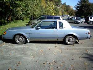

I have a Buick Regal 1983 2 door coupe with a 3.8 liter carburated engine, 130,000 miles. I need information on the vacuum locations in the engine compartment that handle the air distribution to the ducts in the passenger compartment. I have just recharged the ac system and have good cooling but the distribution between max,normal and bi level is not there. The cooling only come out the defroster and lower air ducts. Also I changed the blower resistor,panel switch but can't seem to get high blower
https://images.2carpros.com/forum/automotive_pictures/76499_Buick_4_1.jpg
Aug 16, 2019 at 12:41 PM (Merged)
2CARPRO JACK
  • 11,533 POSTS
There is a small vacuum line that goes through the firewall, it is usually hooked to a vacuum resevoir (round ball). High blower speed is a direct connection from switch to blower, check the wiring with a meter to be sure you are getting through from switch to fan
