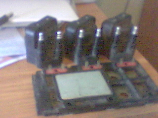

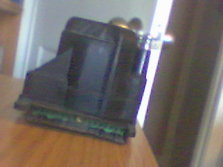

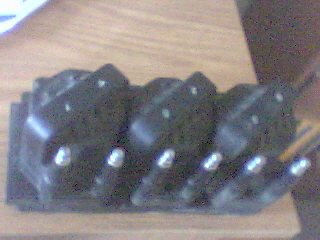

is there any way you can take a picture of your coils and control moduel, there are 3 types of ignition systems for this car or do you know which one you have, one is controled by the ECM (computer) since you said you couldnt pull codes out of it it could be the prob

Was the crankshaft sensor that was replaced- not the cam sensor. will replaced this on monday when i get money to do this.went and got another ignition control module(exchanged) and am going to try this one today.will let you know either way. your help is much appreciated as i would have never figured any of this out. if i take it apart i can put back together , but i didn't know what to take apart or replace. here are the pictures of the coil packs and module.
