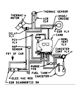

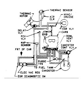

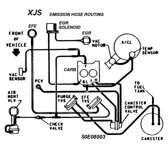

I own an 84 Regal and I had to put everything back together but im havin trouble with the vaccum hose's where do they connect to. it makes it run like a tank and its drinking gas really fast. Could i get some help

https://images.2carpros.com/forum/automotive_pictures/55316_regalvacuumha_1.jpg
High Altitude - Federal
https://images.2carpros.com/forum/automotive_pictures/55316_regalvacuumfed_1.jpg
Federal
https://images.2carpros.com/forum/automotive_pictures/55316_regalvacuumca_1.jpg
California I hope this helps
