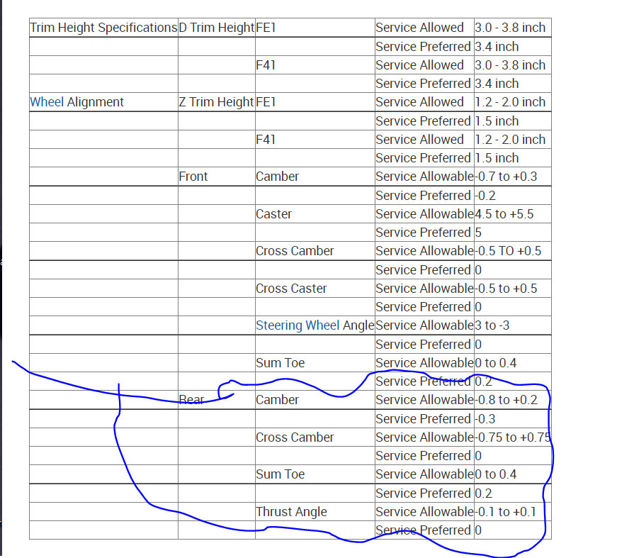

Our car wants to fishtail badly when driving down the road. We were told (by a non Buick professional) that we needed a rear end alignment. What is this (for real? never heard of before) and what problem(s) in the car would prompt such a repair?

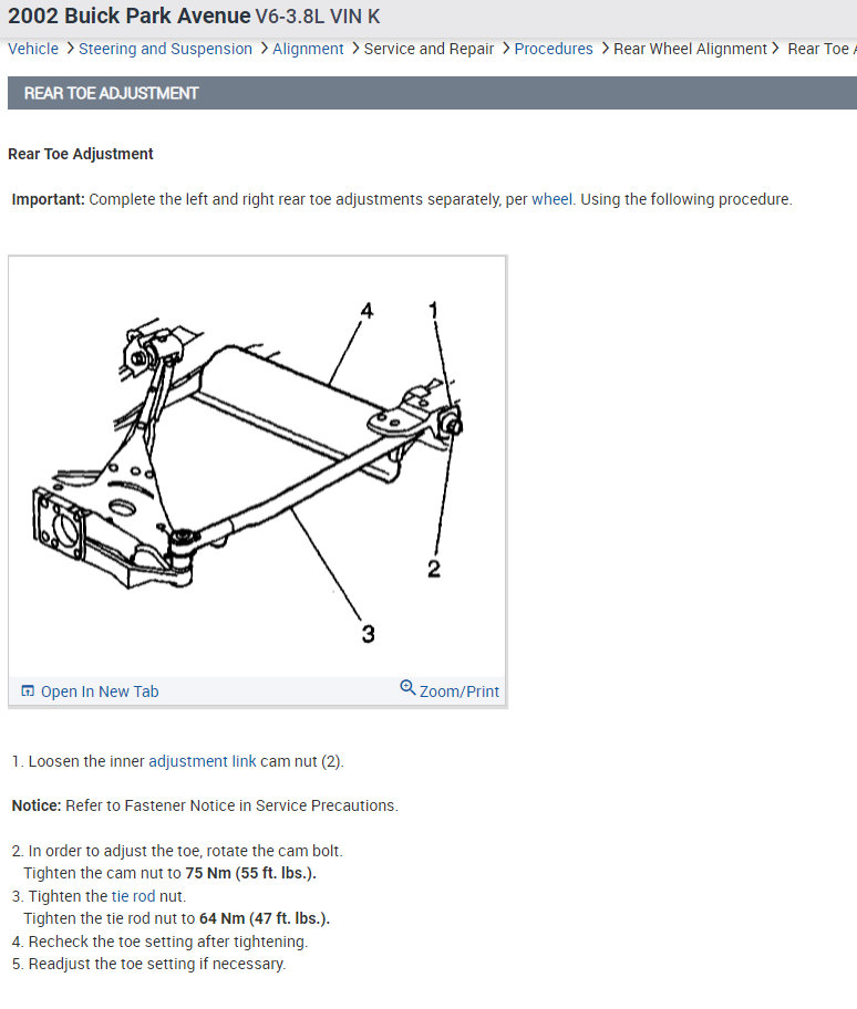

Good afternoon,
The tech was spot on. There always was and always will be alignment required for the rear wheels.
In order to do a proper alignment today, the shop must adjust the rear wheels to spec first before adjusting the front end. Failure to do this will result in handling issues.
The front-wheel settings are based on the rear wheels being in alignment.
I attached the specs for you below to view.
No one is pulling the wool over your eyes. They are 100% correct.
