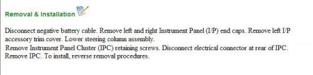

? How to replace the check engine soon light bulb
Sunday, January 31st, 2010 AT 5:35 PM
BLUELIGHTNIN6
MECHANIC
16,542 POSTS
Will need to remove instrument cluster to reach back of it and replace the bulb..
