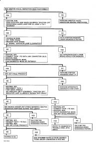

Your reply refers to figure 5. What is that?

Hello. Figure 5 is a breakdown of the diagnostic procedures. which is why i did not put it in the last post .. it is basically telling you to do the preliminary checks in the first part of my last post and then have the vehicle plugged into a TECH scanner !!
https://images.2carpros.com/forum/automotive_pictures/266999_tech_1.jpg
If you right click your mouse on figure 5 you should be able to save it to your computer and enlarge to read it better .. if you have done the visual check of the system most repair shops will be able to read the codes for you !! hope this helps .. let me know

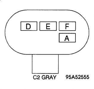

DTC 74 - PRESSURE MODULATOR VALVE (PMV) PRESSURE SWITCH CIRCUIT OPEN OR SHORTED Circuit Description Pressure switch monitors primary brake system pressure. Normally closed brake switch opens when brakes are applied (pressure exceeds 101 psi). If brakes are manually applied during traction control mode (if equipped), Pressure Modulator Valve (PMV) pressure switch input and brake switch input signal EBCM/EBTCM to disable traction control and allow manual braking. Pressure switch is part of PMV assembly and is not serviceable. Test Description DTC 74 will set if EBCM/EBTCM detects open or short to ground in PMV pressure switch circuit. Diagnostic Aids Check for open in circuit No. 853 (Light Blue/Black wire) and circuit No. 1659 (Light Blue wire). Check for short to ground in circuit No. 1659 (Light Blue wire) with brakes applied. Check for PMV pressure switch failure. Fig. 54: DTC 74 Schematic Courtesy of GENERAL MOTORS CORP. Fig. 55: DTC 74 Flow Chart (1 Of 3) Courtesy of GENERAL MOTORS CORP. Fig. 56: DTC 74 Flow Chart (2 Of 3) Courtesy of GENERAL MOTORS CORP. Fig. 57: DTC 74 Flow Chart (3 Of 3) Courtesy of GENERAL MOTORS CORP. Let me know if you need any of the diagrams listed !!
