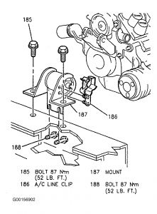

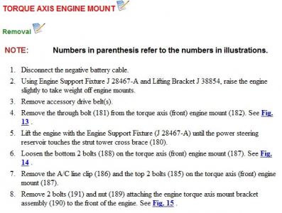

My Question is,
How do I remove My Left motor mount? So far I have removed all the bolts but their are two studs holding it in place. Do I squeeze mount in order to release mechanism?
ThankYou

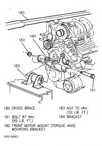

https://www.2carpros.com/forum/automotive_pictures/261618_Noname_2207.jpg
https://www.2carpros.com/forum/automotive_pictures/261618_Noname2_718.jpg
FIG. 13
https://www.2carpros.com/forum/automotive_pictures/261618_Graphic_512.jpg
FIG. 14
https://www.2carpros.com/forum/automotive_pictures/261618_Graphic2_77.jpg

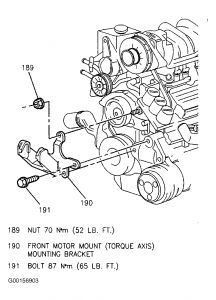

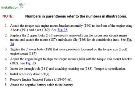

FIG. 15
https://www.2carpros.com/forum/automotive_pictures/261618_Graphic3_14.jpg
