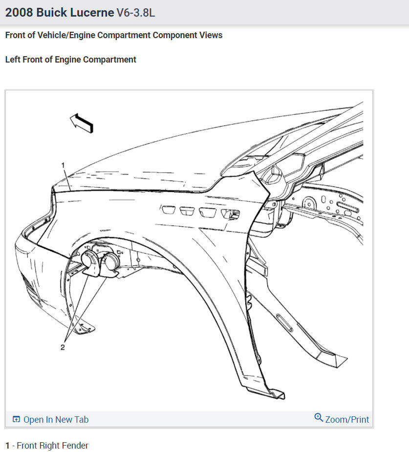

Hello. The horn has been replaced once by GM and is dying once again. (Car has 56K). It happened after driving in a heavy rain storm this spring. I believe it is a design flaw. Do you know if I could replace the horn (or have it replaced) with a 90's or later 4-tone Cadillac Brougham or Deville horn (for a nicer sound)? Would that horn fit the car and would it withstand water any better? Thank you.

The four tone horn is actually produced by four horns. It would require some wiring additions to achieve the retrofit, if it is possible. Is it possible that some splash protection is missing or broken, and/or the horns are mounted in such a way that they capture water and retain it? Check out the diagrams (Below). Please let us know what happens.

Have you checked for a blown fuse? That would be caused by a shorted horn. Do you hear the horn relay click? If not, it's much more common to have a broken clock spring. That's a wound-up ribbon cable in a plastic housing under the steering wheel. Other systems will also fail if that ribbon cable is breaking, most notably the air bag system and cruise control.
The horns are just inside the front of the left front tire. Check out the diagrams (Below). Please let us know if you need anything else to get the problem fixed.

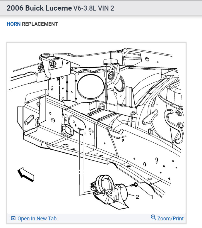

My 2006 Buick Lucerne CXS started having issues with the horn today and i need help troubleshooting.
The horn sounds very small and muffled now, instead of the strong loud sound it had previously. It still sounds when I activate it, however it just sounds very muffled, like a toy.
My husband and I have looked in the engine compartment but cannot even locate the device to see if it may be somehow blocked.
Will you please let me know where the horn is located and if you have an assessment of what may be wrong with the device?

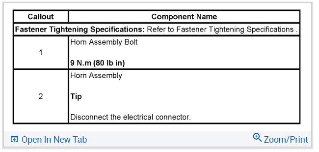

the vehicle has a high pitch and low pitch horn,sounds like the high pitch horn is burnt out.they are an assembaly,they are replaced as a unit.the location should be in the pass front of the car,you might have to remove the pass headlight assembaly to see the horn.should be 1 connector and 1 ten mm bolt. post back with what you find.
