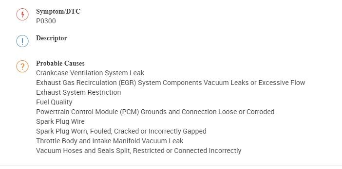

The code is P0300 multi cylinder failure. Also, noticed today when doing a test drive if I make a left u-turn I hear a what sounds like a grinding sound. Thanks for any and all help.

probably bad gas or water condensation. to be sure you need a real mechanic. Has to be able to check pids data and verify its fuel cause misfire. i can guess more but you have to give me more information.

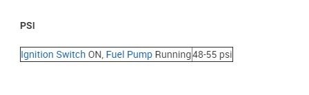

Good evening,
I would start by replacing the plugs and wires. From sitting, the wires may have got hard and are leaking electric.
I would also check the fuel pressure to be sure the fuel pressure is correct. Low fuel pressure will set a 300 code.

2. To relieve the fuel pressure, refer to Fuel Pressure Relief Procedure. With the ignition switch ON and the fuel pump running, the fuel pressure indicated by the fuel pressure gauge should be 333-376 kPa (48-55 psi). This pressure is controlled by the amount of pressure the spring inside the fuel pressure regulator can provide.

Mar 24, 2020 at 10:44 AM
Suggested Repair
Replace the spark plugs and plug wires, which may have hardened after the car sat and begun leaking spark. Also check fuel pressure, since low pressure can cause a P0300 random misfire. Have a mechanic verify fuel-system data before a long drive, and inspect the grinding noise heard during left U-turns separately.
