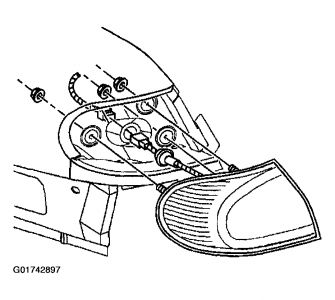

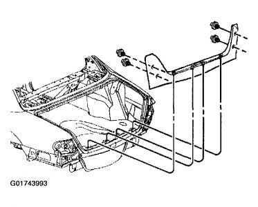

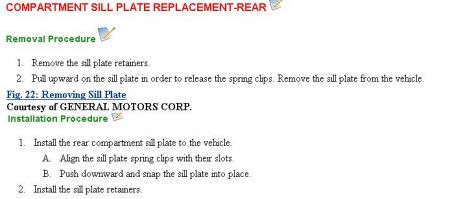

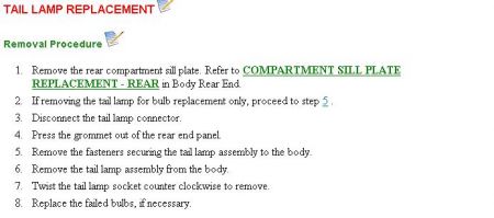

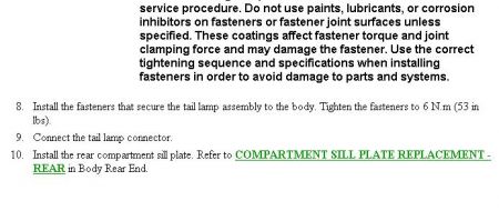

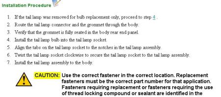

How do you change the brake light on the outside and also the lights on the trunk lid. I can not seem to find a way to get them off to change the lights and I don't want to break anything. Please advise on how to change the lights in the rear tail lights and also the blinker bulbs
+1
Friday, September 11th, 2020 AT 1:26 PM (Merged)
  • 109,885 POSTS
Hi:
You need to remove the light assembly to replace the bulbs. Open the trunk, and you may have to move some of the carpet to find the wing nuts that hold the lens in place. Remove the plastic wing nuts and remove the lens assembly, replace the bulb, and reverse the sequence. As far as the 3rd brake light, I believe you need to gain access to the bulbs from the trunk also.
