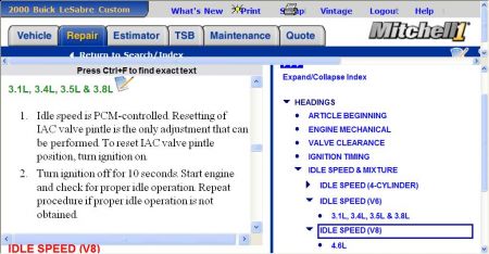

Did you clean out the IAC passages thoroughly? If so try doing below and see what happens. I cannot find the air bypass screw -somewhere within the throttle shaft there's a stopper screw that you can open and close the throttle plate check if it has one.
https://images.2carpros.com/forum/automotive_pictures/12900_iacv_10.jpg
