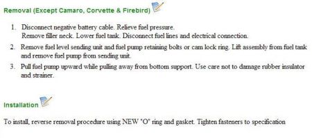

Do you know the location of the fuel pump, and how hard it is to replace. I really appreciate your help.
Wednesday, April 29th, 2009 AT 9:31 AM
BLUELIGHTNIN6
  • 16,542 POSTS
Fuel pump is attached to the fuel sending unit which is located in the fuel tank. Replacement procedures are below..
https://www.2carpros.com/forum/automotive_pictures/261618_Noname_496.jpg
