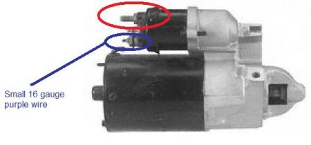

how do I reconnect a starter to a 1997 buick century I lost track of the wireing

You have about 5 wires but only 2 screw holders. Locate the small screw with 8mm nut. One of the screws has a tiny eyelet to go through that. The rest go to the bigger 13mm nut.
