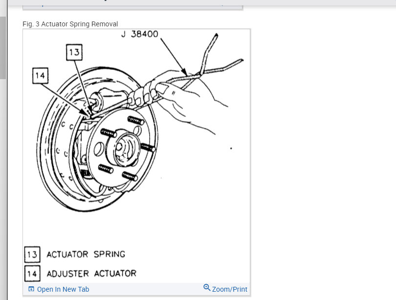

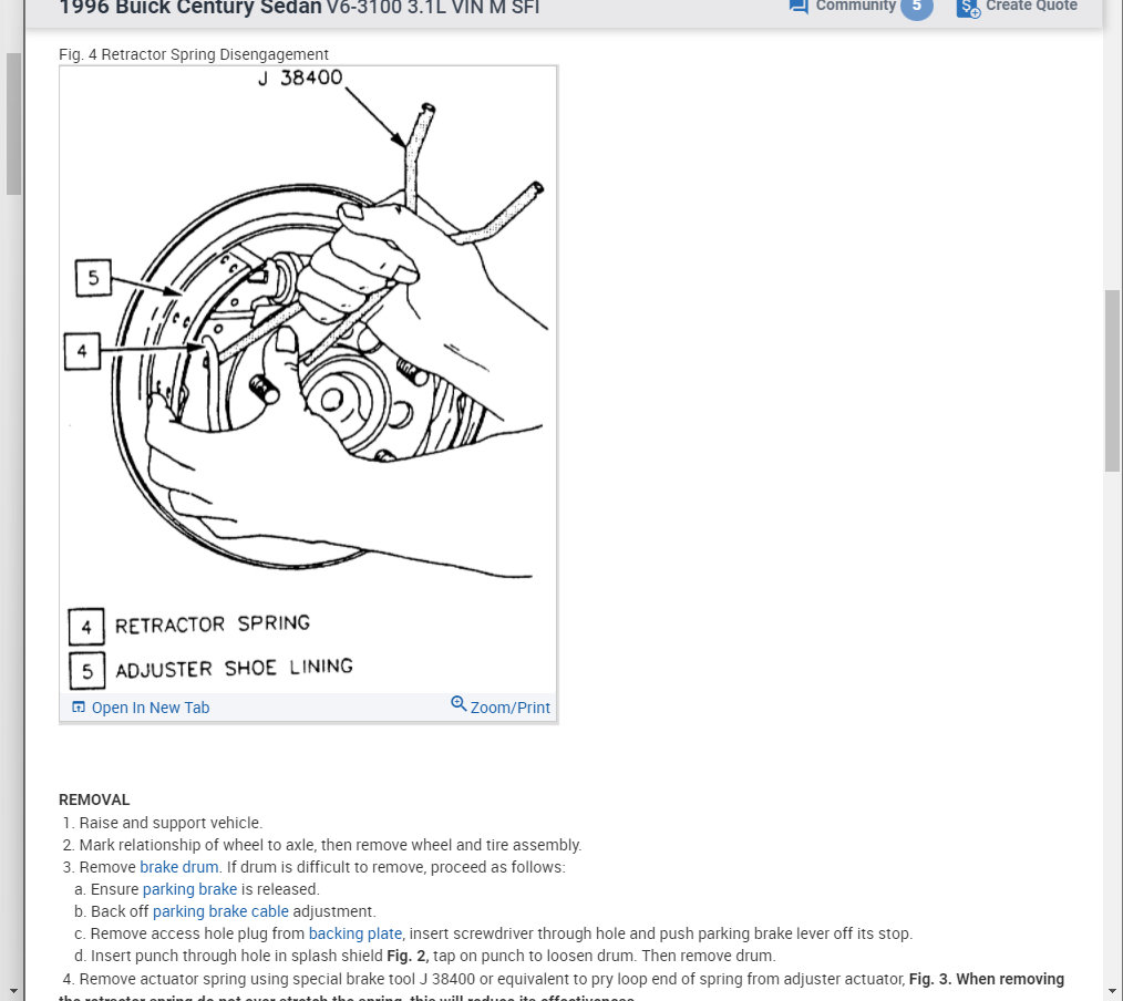

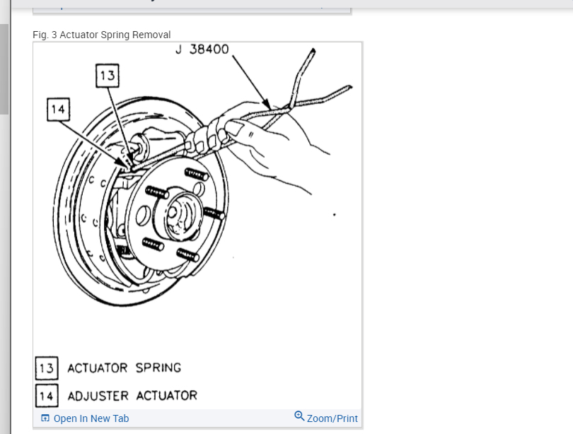

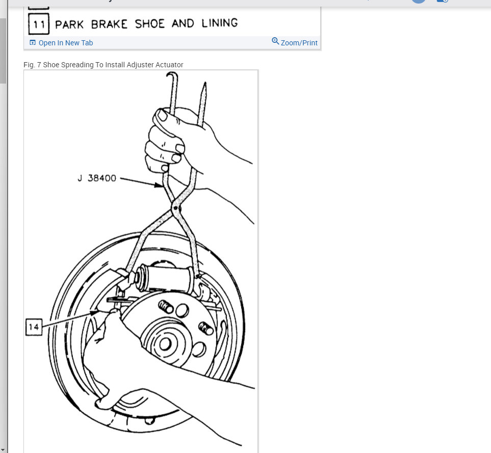

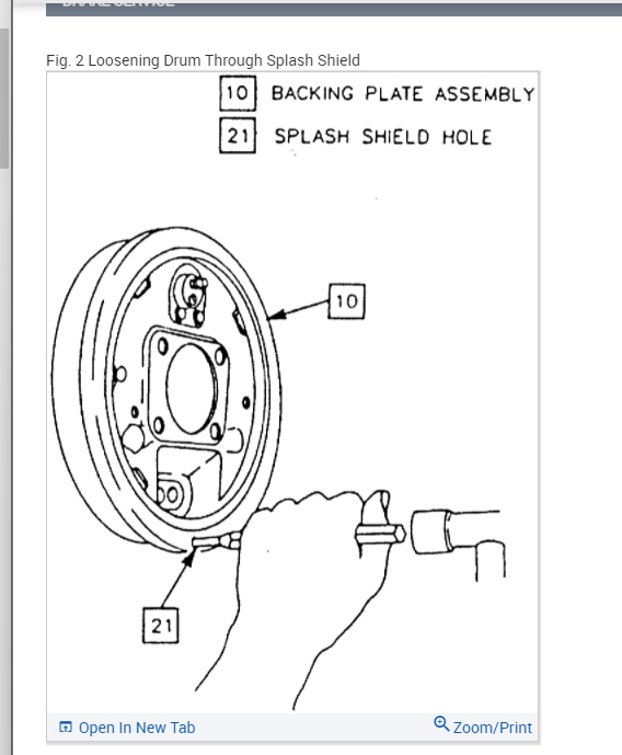

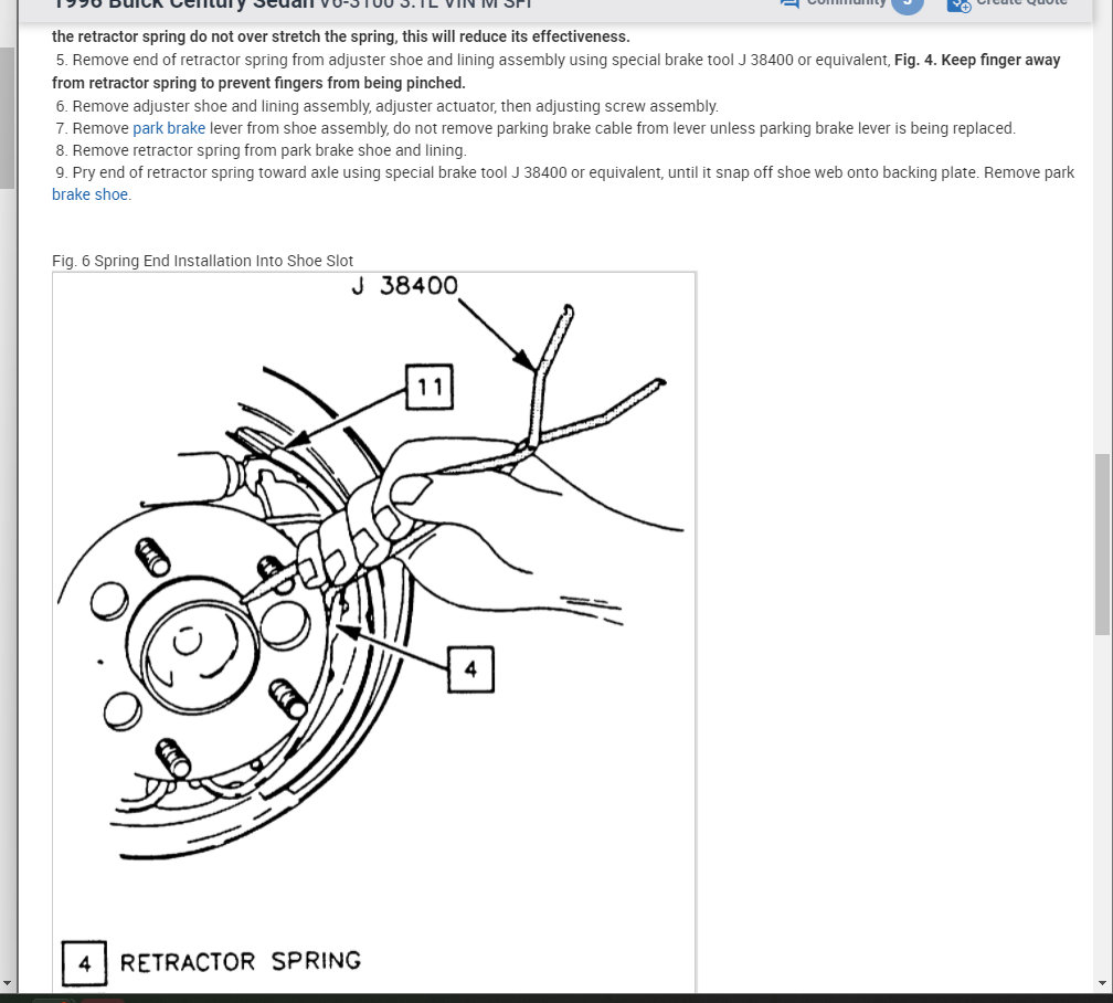

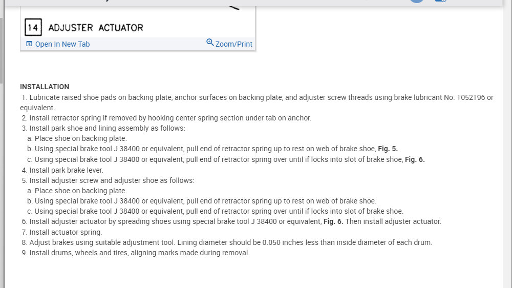

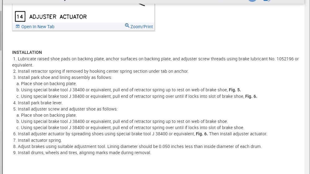

I am attaching the process below on how to replace these. We should measure the shoe anyway just to confirm what you are looking at.
Let me know what questions you have on this.
