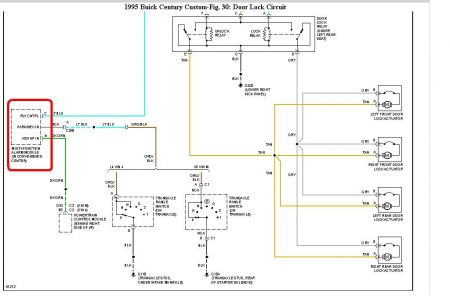

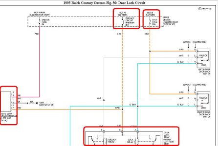

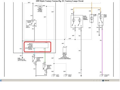

So the problem starts one day while I'm driving and my electrical locks keep locking on their own while I'm driving down the road constantly. Then when i park my car my ceiling light and floor lights never go out. So I try reopening all the doors and closing them firmly so that maybe they'll shut off. I got them to go out but i came back out to my car about 30 minutes later and they had come back on at some point. I thought maybe some condensation got down in the controls but it kept doing it for a few days til finally it had drained my battery. So i got my car started again and when i came to park it i pulled the fuse for the interior lights out so i couldn't kill my battery over night. Next day the battery was more dead than ever. So I'm not sure what the source of the problem is nor how i would go about fixing it. Any thoughts?

The one thing in common between the power door lock and courtesy lamp is the multi function alarm module inside the convenience center. I would also check the relay, circuit breaker and fuses (circled) to start with.
