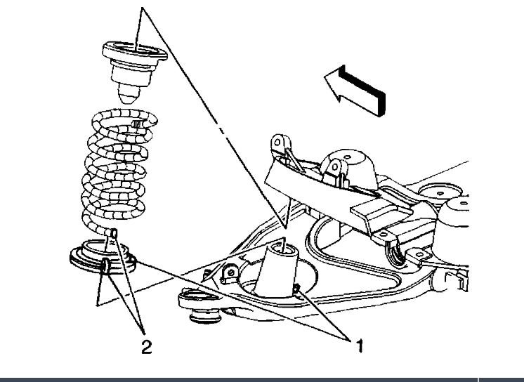

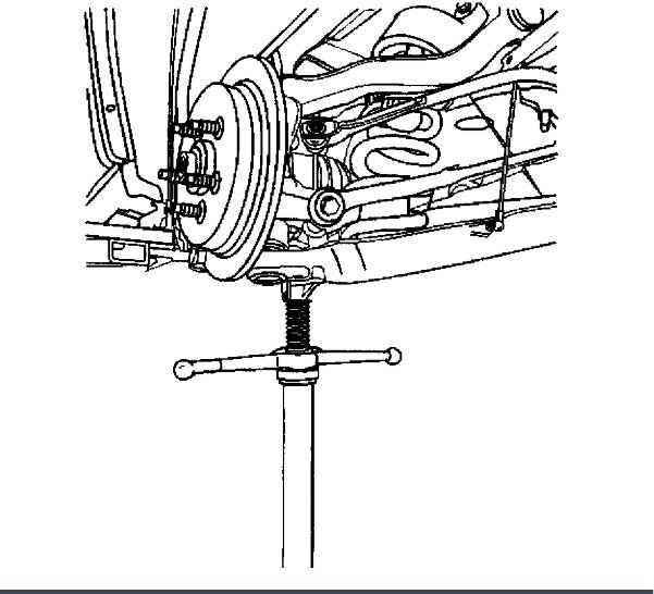

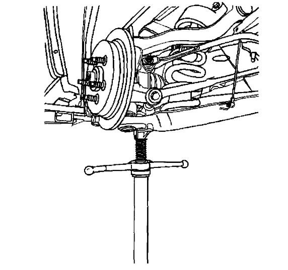

Do i need to compress springs to install and do i have to remove axles?
Feb 20, 2020 at 10:53 AM
Good afternoon,
You will need either a deadman jack if you use a lift or a floor jack if you are doing it on the floor.
No, the axle does not have to be removed.
I attached pictures for you to view for the procedure.
Coil Spring Replacement (All Wheel Drive)

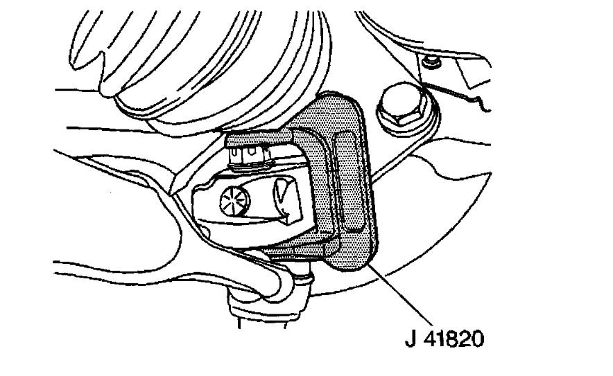

J 41820 Ball Joint/Stud Separator

1. Raise and support the vehicle. Refer to Vehicle Lifting.
2. Remove the rear wheel.
3. Remove the brake caliper and support the bake caliper. Do not disconnect the brake hose.
4. Disconnect the tie rod from the knuckle.
5. Use a utility stand in order to support the lower control arm.

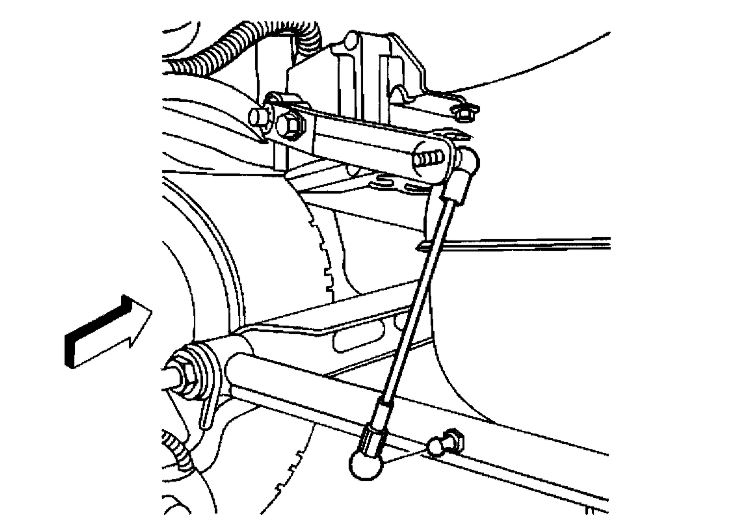

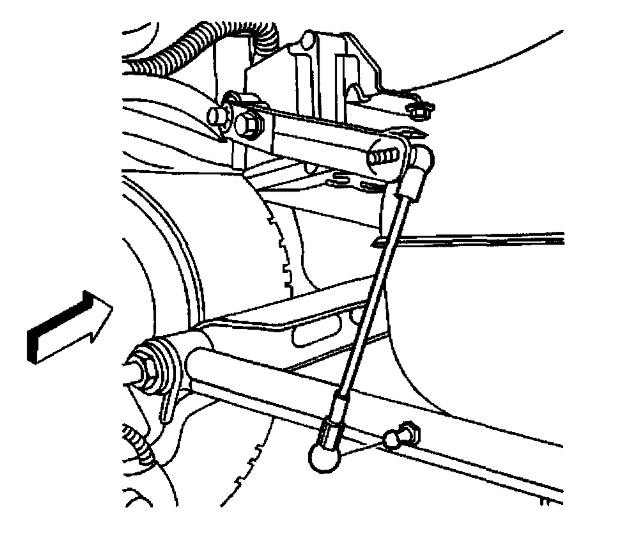

6. Disconnect the height sensor link from the lower control arm.
7. Disconnect the shock absorber from the lower control arm.

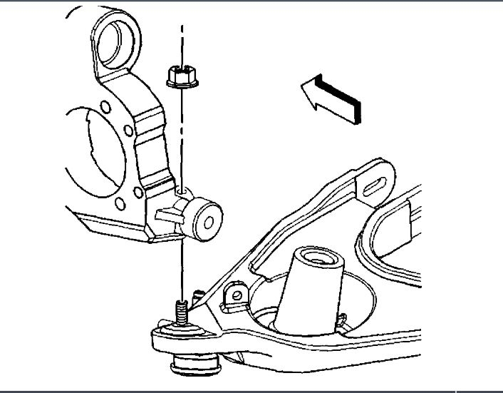

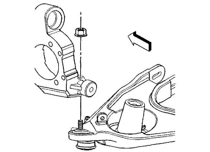

8. Use the J 41820 in order to disconnect the ball joint from the knuckle.
9. Remove the lower ball joint nut.

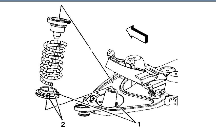

10. Use the utility stand in order to lower the control arm and relieve the coil spring tension.
11. Carefully remove the coil spring and jounce bumper (2).
Installation Procedure
1. Install the spring jounce bumper to the spring.
2. Index and install the spring insulator to the spring (2).
3. Index and install the spring seat with the spring and the jounce bumper to the lower control arm (1).

5. Install the lower ball joint to the knuckle.
Notice: Refer to Fastener Notice in Service Precautions.
6. Install the lower ball joint nut.
Tighten the lower ball joint nut to 85 Nm (63 ft. lbs.).

8. Connect the height sensor link to the lower control arm.
