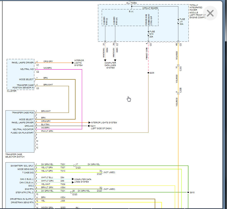

Back in 2018 the front driveshaft on my truck broke in two while driving on freeway. Selector was in 2WD at the time. Had to remove shaft on side of the road. Been without 4x4 ever since. Anyone ever seen this happen before? Now I'm wanting to have shaft rebuilt but not sure what caused this failure. Currently no lights at electronic selector knob or selector status on instrument cluster. Erased Serv4WD light by hooking positive and negative battery terminals together. No other codes. Fuses all good suspect short in wiring. Any help much appreciated.

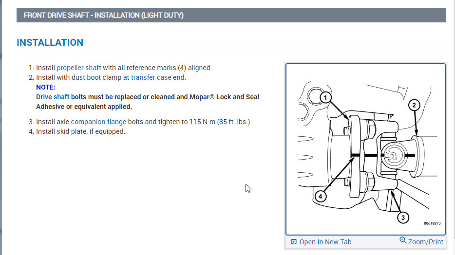

So unfortunately we need to get the vehicle put back together and find out what it is doing.
Below is the process on how to install it so let's do this and see what we are dealing with in addition to the possible engagement and we can go from there. Thanks

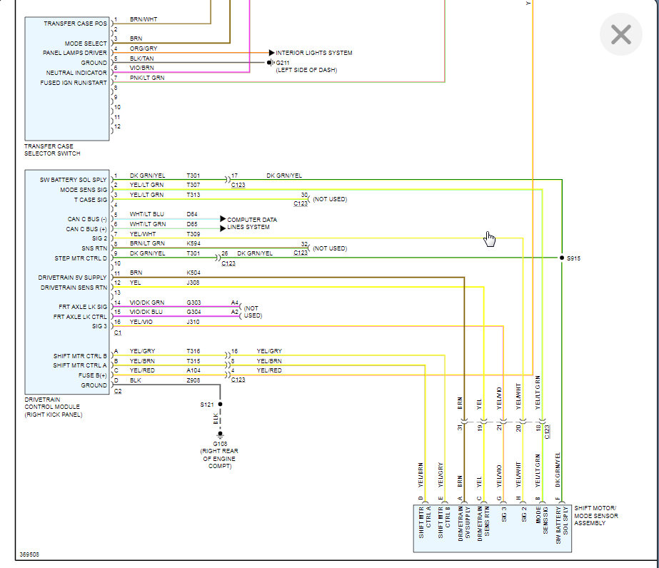

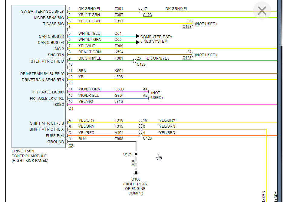

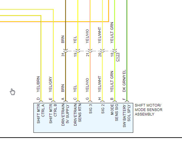

The only thing we can really do at this point is test the control module and if the shift motor is moving/engaging.
If it is then it is all working like it should but we won't know for sure until we see how it operates when the drive shaft is in.
Below are the wiring diagrams for your review.
