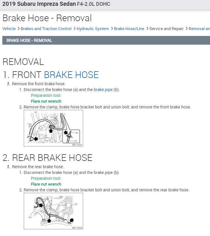

Heating up of the brakes typically points to sticking caliper.
Does is heat up on both front or just one side?

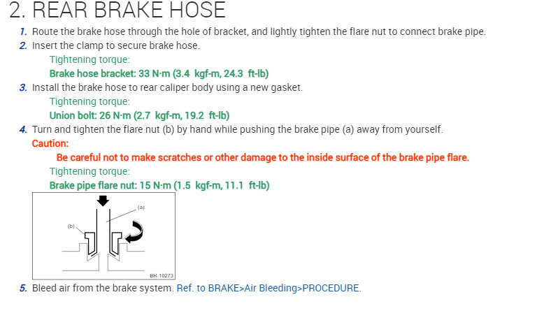

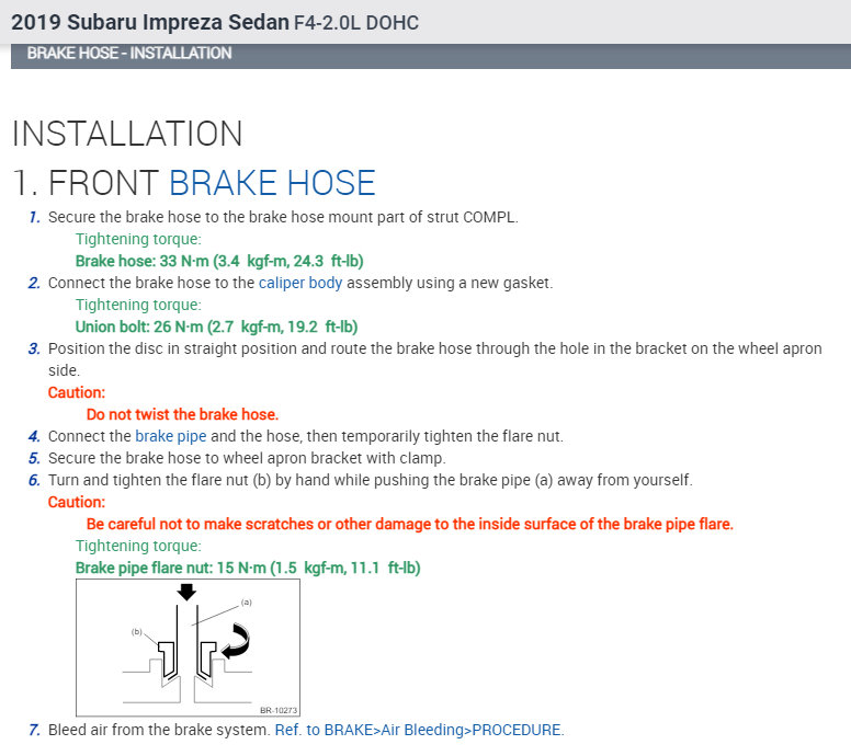

A caliper can stick due to internal wear of the caliper or a clogged brake hose. If the brake hose gets clogged it will not allow the brake fluid to travel back when the pedal gets released. This makes the piston of the caliper stay in extended position and the brake pads rubs against the rotor (crating noise).
https://www.2carpros.com/articles/brake-caliper-replacement
Being that your Impreza is only 2 years old and 26,000 miles, this type of issue should be covered under warranty.
Have you contacted the dealer with this issue?
