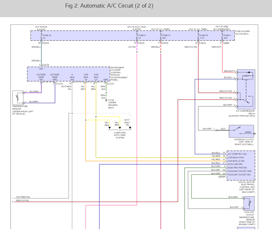

i have installed brand new A/C system, new aux fan, radiator, compressor ans expansion valve. A/C works great but it doesn't come on right away then after several minutes of driving it comes on.
Some sensor?

Can you say if the air blowing through the vents is not working or the air is blowing but not cold?

Hi, and thanks for responding.
Like i said in my question originally, A/C system is brand new, compressor, aux fan, radiator and expansion valve. When the A/C finally kicks on (aux fan and compressor clutch) the system works perfect, ice cold A/C. there is some delay for that to happen and i cannot figure out. yesterday i had Freon tested by a certified mechanic, he does not know the answer to my problem. i am thinking some kind of sensor, i think there is an aux fan sensor?

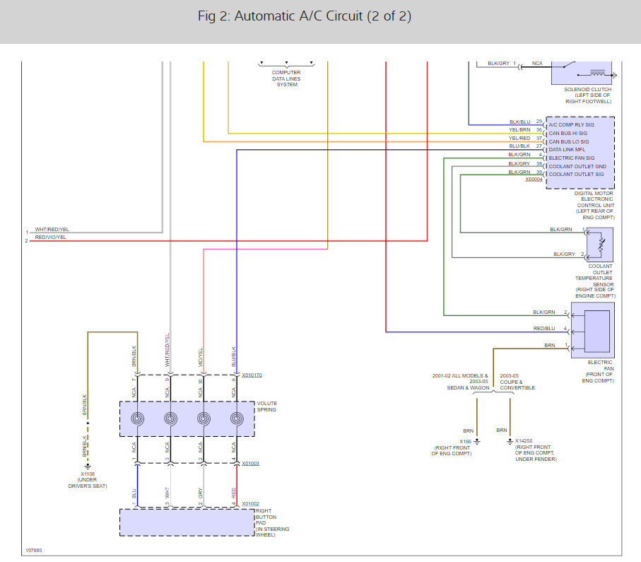

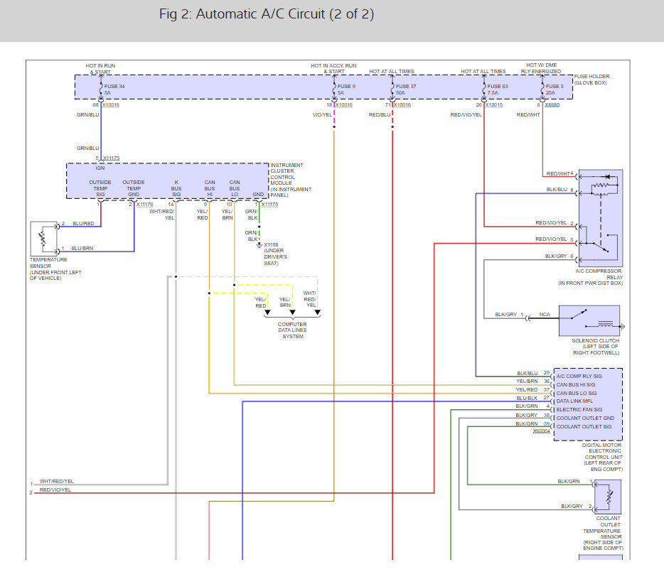

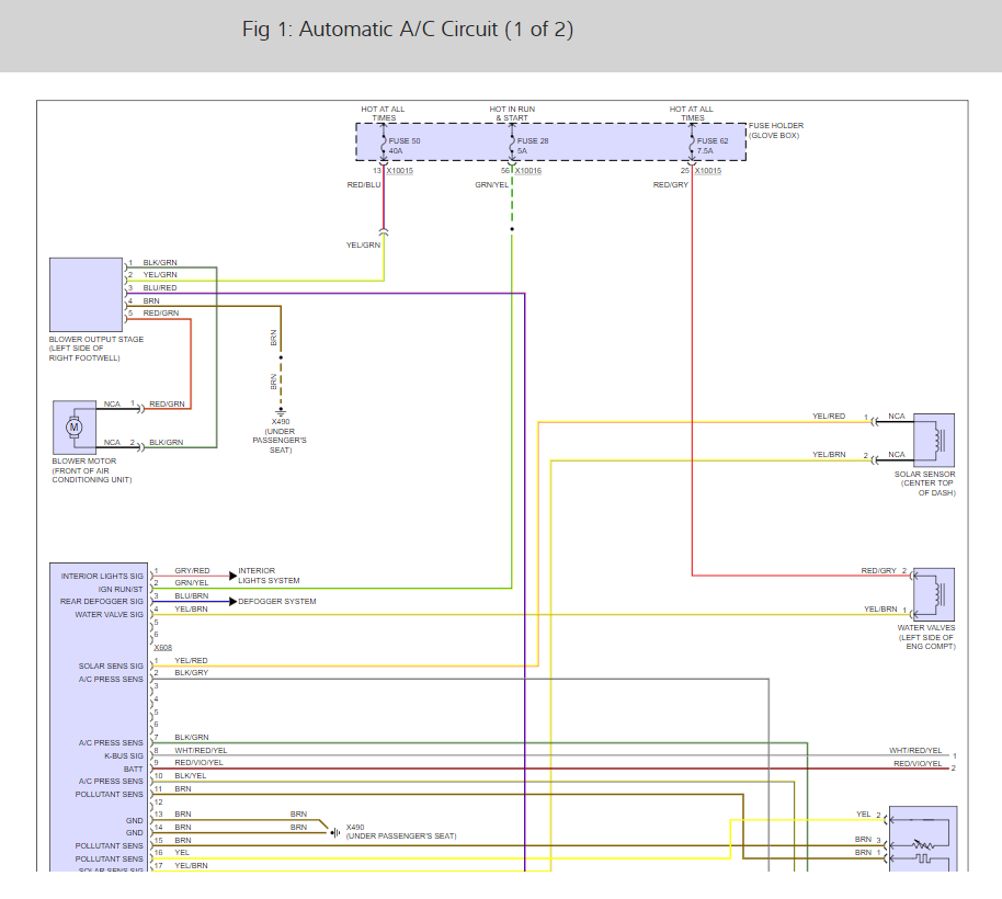

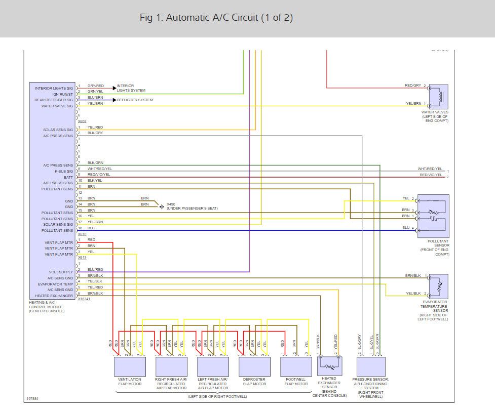

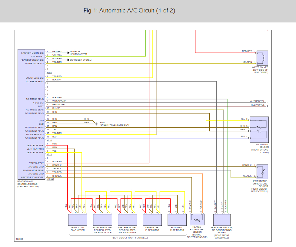

It sounds like the HVAC controller is not working correctly. but to be sure let's check the output signal using this guide and the air conditioner wiring diagrams below:
Mar 19, 2019 at 3:43 AM

been awhile since we communicated.

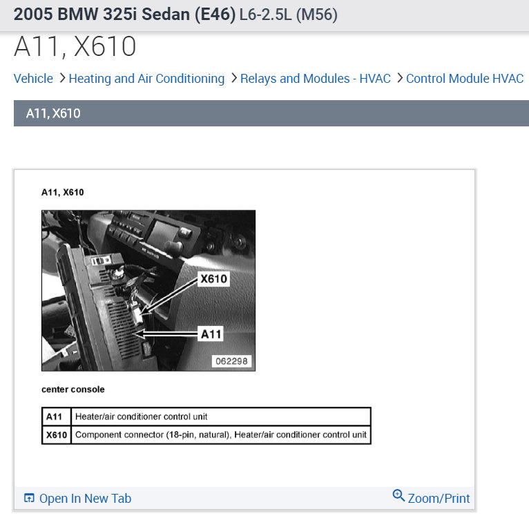

i have done a whole lot of trial and error with this situation , changing, coolant sensor, ambient temperature sensor, aux fan relay, compressor relays and to no avail, until i had my friend put on ac computer and the code that came up was solar sensor, i did loads of research and couldn't find much information because apparently these do not go bad very often. i even had BMW try and diagnose, and they couldn't figure it out.
finally i found the location in the front window down in the dash.
i hooked it pulled it out and exposed it and i started to get more response from system.
changing this thing is to pull out complete dash and cluster which i can't afford so i am buying a new one and splicing to old wiring , should work.
but that was the whole problem,
thanks for your help figured you would be interested in final conclusion.
