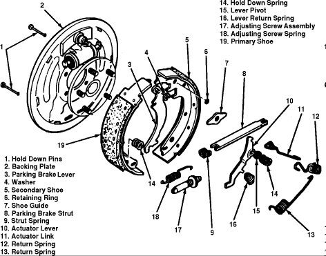

When I push downs on pedal it mashes down almost to the floor and sounds like I am losing air. I did put a new master cylinder in about a year ago. It does not seem like I am losing any fluid.

Hi and thanks for using 2CarPros.com. I assume the rear braked are a drum system. The first things I want you to look at is this like that describes symptoms.
https://www.2carpros.com/articles/brake-pedal-goes-to-the-floor
Now, with rear drum brakes, it is very common for the shoes to get out of adjustment. The result is a spongy pedal, which is similar to what you described. Safely lift the rear of the vehicle, block the tires so it cannot move, and support it with jack stands. Place the transmission in neutral. Spin the rear tires, one at a time. There should be a slight drag. If there is not and they spin freely, they need adjusted or replaced.

Here are specific directions for your vehicle. Additionally, I attached an exploded view of the brake system as a guide.

I hope this helps. If you find this is not the problem, there are no leaks, and everything is working properly, I would suspect the master cylinder has gone bad again. The air noise you hear can be normal due to increased pedal travel or you could have one of the following:
Leaking vacuum line.
Leaking vacuum booster diaphragm.
Damaged gasket silencer.
Master cylinder going bad allowing brake fluid to enter the booster.

Okay, the back brakes were low so I put on new back brakes . I bled the system just to make sure no air and there was not. Okay, nothing I did helped it is still doing the same thing brake pedal goes almost all the way down truck barely stops. The fluid does not seem to be going down in the master cylinder. How do I tell if the master is bad or could it be the booster?
Mar 15, 2021 at 11:47 AM
  • 54,840 POSTS
Yes, an easy trick is to use vise grips and gently close off the three brake flex hoses and see what the pedal does this will isolate the master from the wheels to me it sounds like the booster though.
