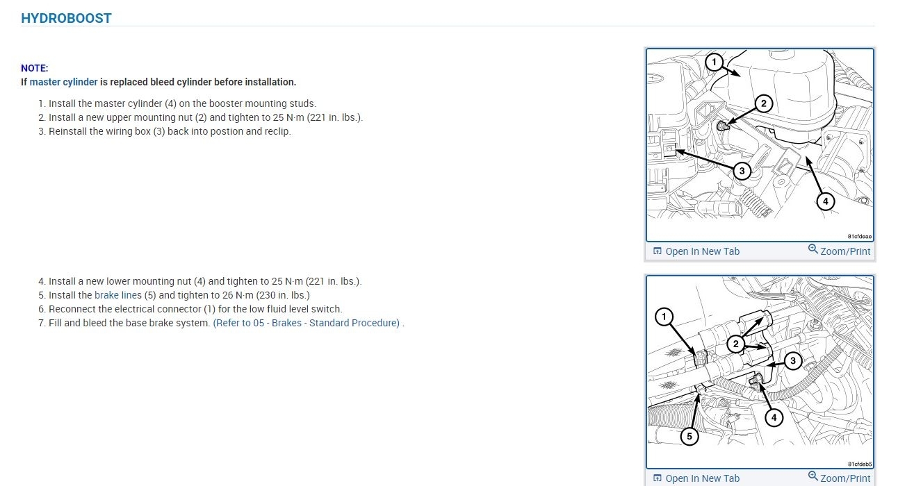

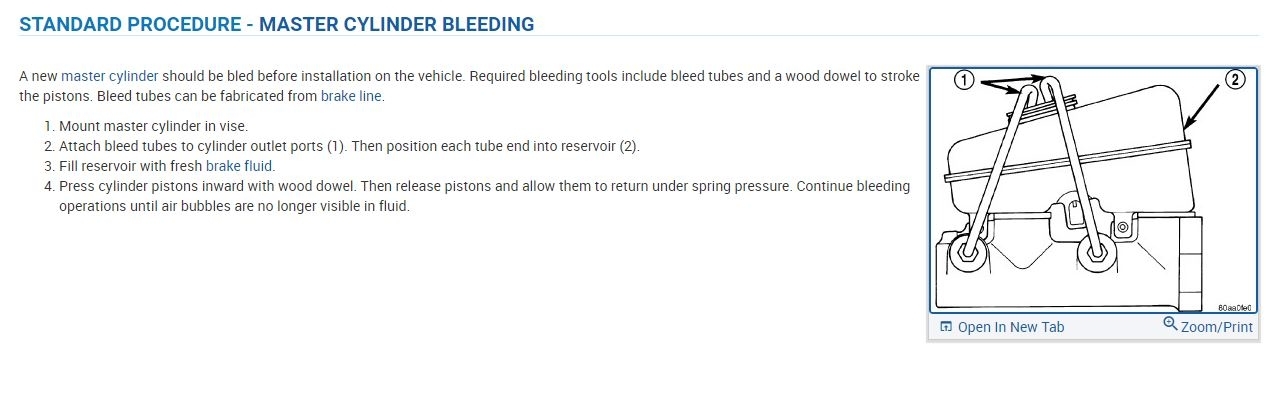

Good morning,

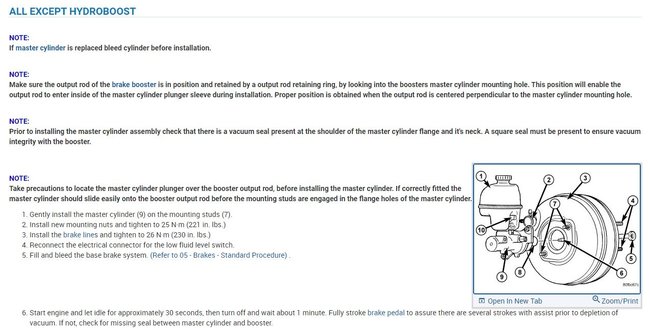

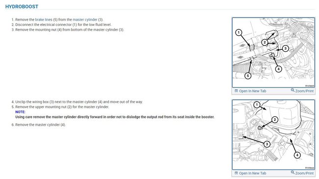

This sounds like the master cylinder has failed internally. The seals internally are not allowing pressure build-up. This comes from pumping the pedal after you replace the pads. The brake pedal goes down to the floor a couple of times and if the fluid was dirty, it can damage the seals.
https://www.2carpros.com/articles/brake-pedal-goes-to-the-floor
https://www.2carpros.com/articles/how-to-replace-a-brake-master-cylinder
https://www.2carpros.com/articles/how-to-bleed-or-flush-a-car-brake-system
