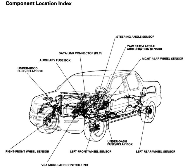

ABS light and VTS light came on. also brakes seem like they are tighter. have already replaced the master cylinder and two calibers and problem is still occurring. could this be ABS speed sensors causing the issue?

Here are the testing and inspection directions from Alldata. The attached pics correlate with the directions.
Wheel Sensor Inspection
1. Check the magnetic encoder (A) after cleaning. If necessary, replace the wheel bearing.
see pic 1

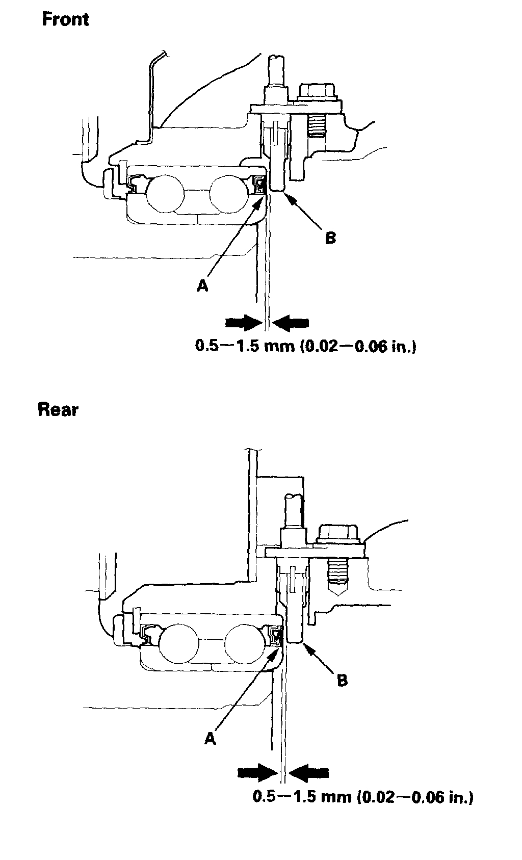

2. Measure the air gap between the wheel, sensor (B) and the magnetic encoder all the way around while rotating the encoder.
Standard:
Front: 0.5-1.5 mm (0.02-0.06 in.)
Rear: 0.5-1.5 mm (0.02-0.06 in.)

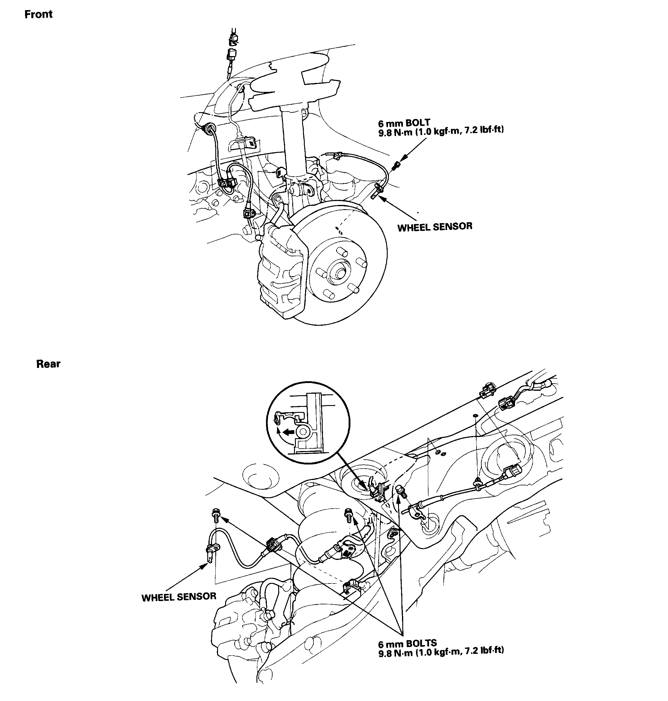

Picture 2 shows how they are replaced on your vehicle, and pic 3 shows locations.
