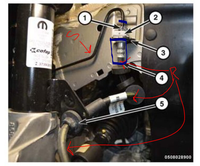

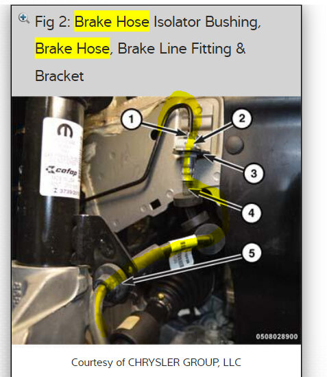

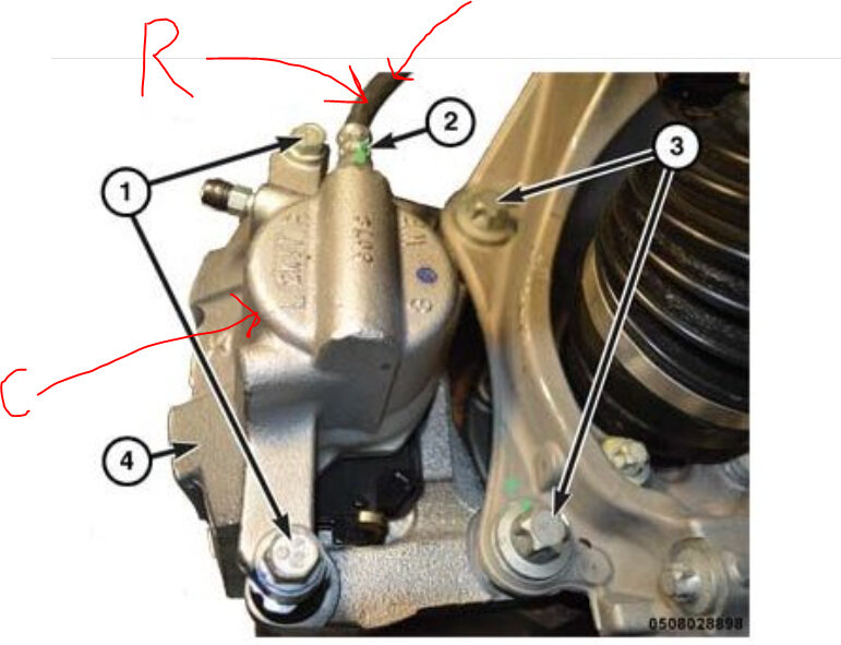

Either a steel brake hose has rusted through, a rubber brake hose that attaches to the brake caliper has ruptured, or there is an issue with the brake caliper.
I don't recommend driving it like this unless you can drive really slowly (under 20 MPH), the parking brake is working properly, and you still have some brake usage.
Keep in mind, the brake fluid from the master cylinder will empty and basically, you will not have much at all as far as braking.
I attached two pics below showing the steel brake line (S), rubber brake hose (R) and the brake caliper. These are located behind the wheel. Check to see if you can determine where the leak is coming from. If it is the rubber hose, we can take care of that somewhat easily. The steel line will require more time and effort.
Let me know. Also, the more I think about it, you shouldn't drive it regardless of the aforementioned suggestion.
Let me know what you find and if I can help.

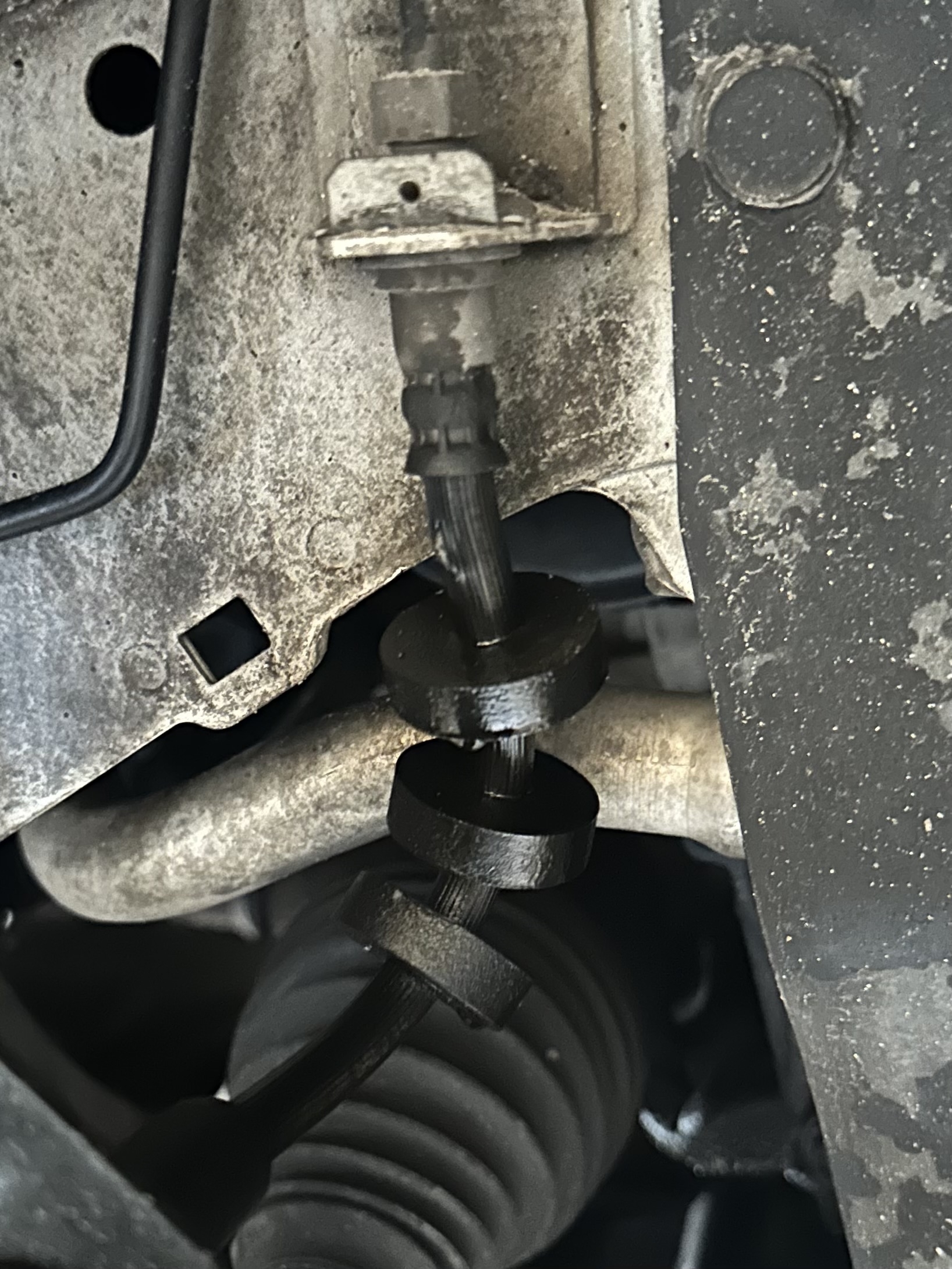

I apologize I don’t know what it’s called (though I’m sure you told me), but my husband discovered this piece is what leaking and is cracked at the top which is slightly visible in the picture when looking closely.
Thanks again for your help!
Mar 13, 2024 at 3:04 PM
  • 110,194 POSTS
Yep, that's the rubber brake hose. It runs from the steel brake line to the brake caliper.
If you want to do it yourself, contact any auto parts store and tell them you need the rubber brake hose for the right front (passenger side).
Once you get it, the hose will unbolt from the steel line and the caliper. It is important to make sure everything is clean and tight when you install the new one.

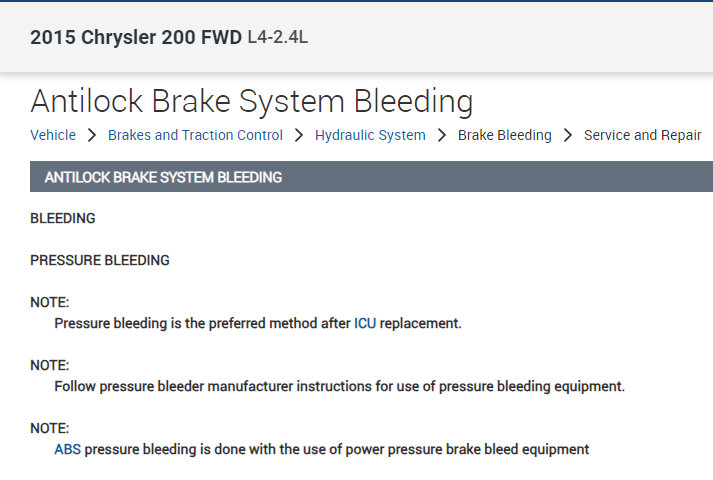

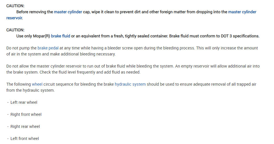

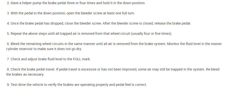

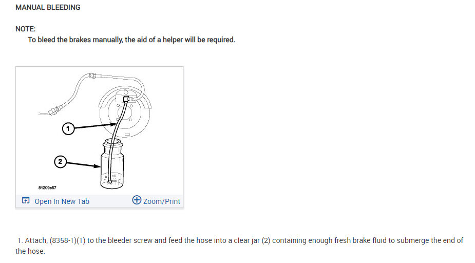

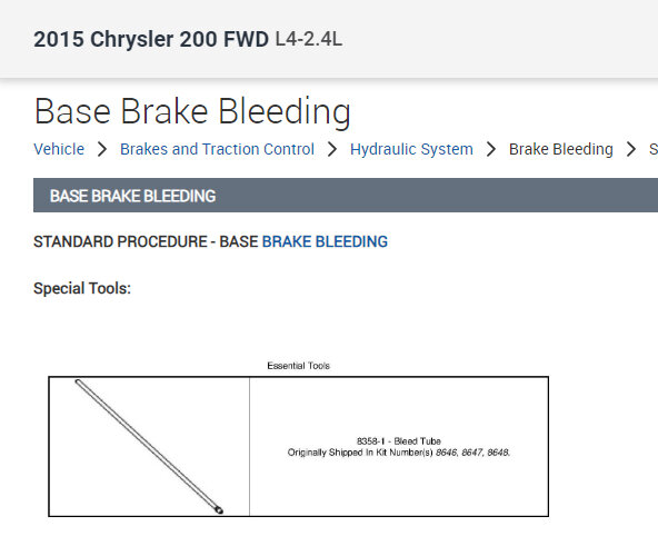

Once the new one is installed, you will need to bleed the brake system to eliminate any air that entered the system. If the brake master cylinder is empty from leaking, you will need a scan tool to bleed the ABS system.

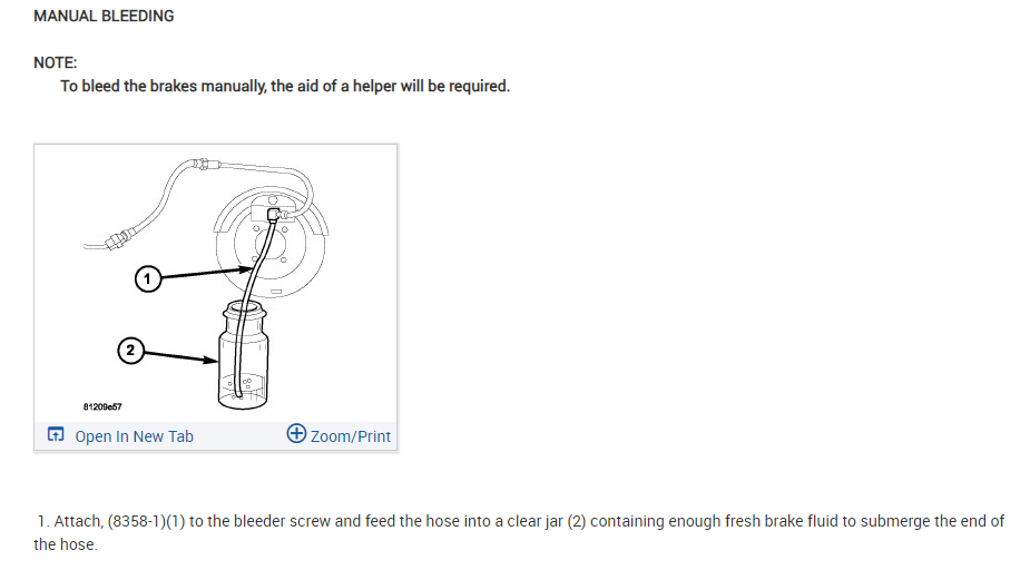

Step one would be to manually bleed the brakes. See pics 1-4. If the brake master cylinder did not fully drain, you may get away with doing the basic manual bleed. Note: This will take two people to do.

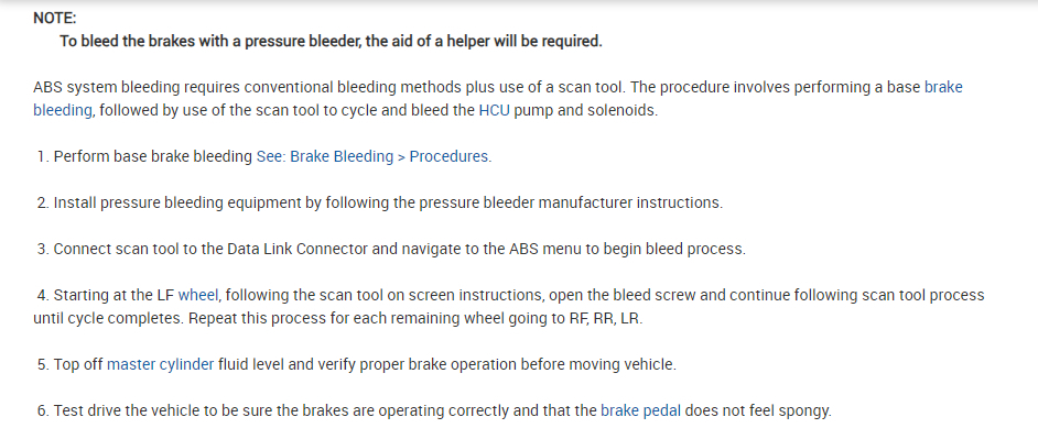

If you complete the base bleed and the brake pedal is soft or doesn't feel right, then the ABS bleed procedure will need to be performed. You will need a scan tool and pressure bleeder for this. That is something most people don't own. However, I did add the directions. See pics 5 - 6.

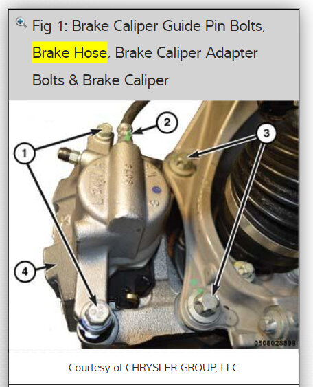

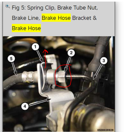

You are very welcome. Let me know if I can help in any way. Also, I found a few pics showing where the hose attaches at each end. I don't know if you need them but figured it may help.
Take care and let me know how things work out for you.
