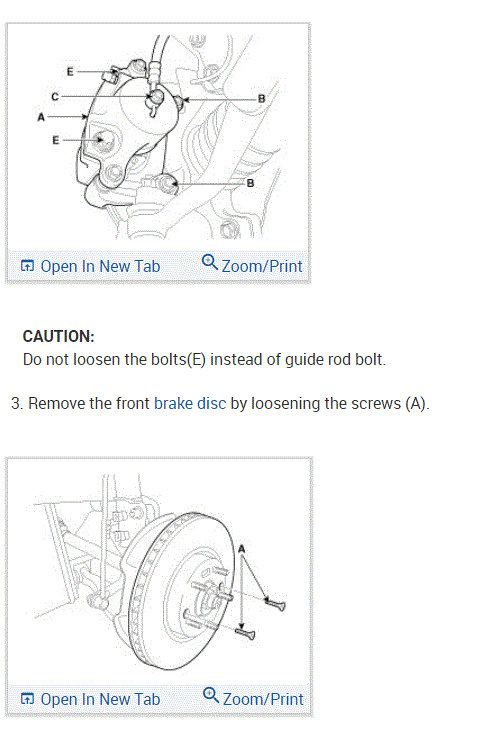

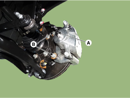

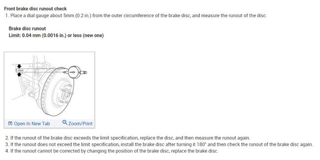

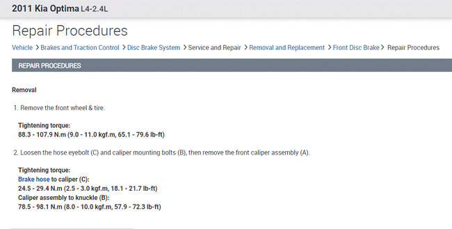

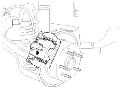

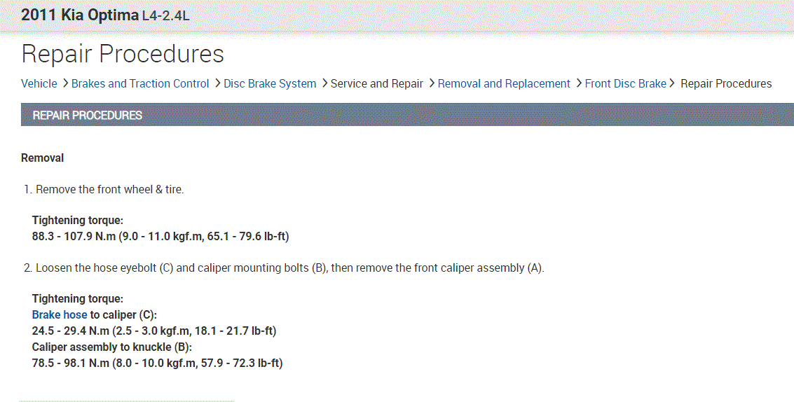

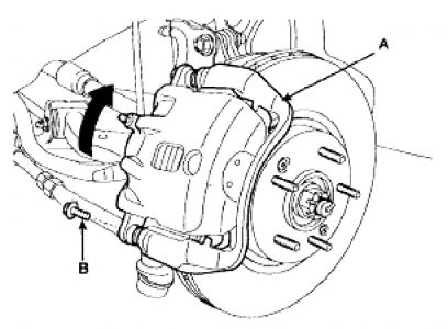

Replacing brakes and rotors isn't too hard of a job. You can expect them to last approx 25,000 miles, but that is based on driving habits and terrain.
First, here is a link that explains in general how it's done. You can use this link as a guide.

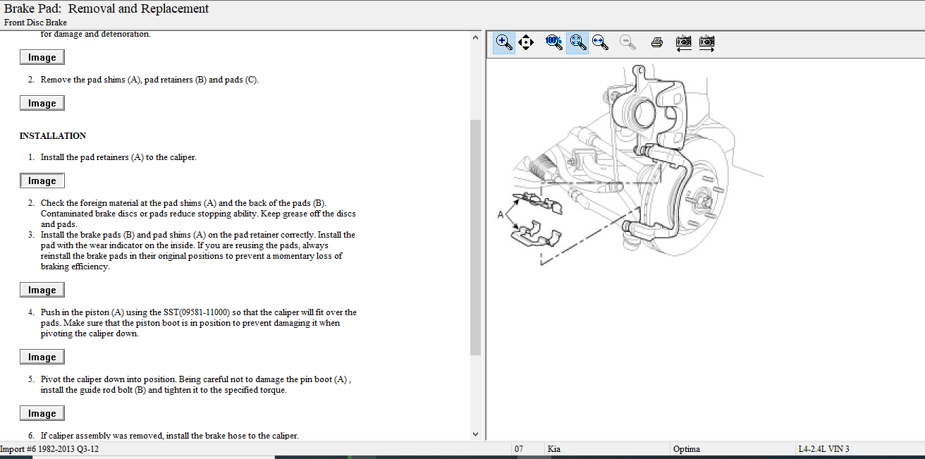

Here are the directions specific to your vehicle. The attached pics correlate with the directions.
Be careful not to damage the hub bolts when removing the front wheel & tire.
Loosen the guide rod bolt (B) and then remove the caliper body (A).
Tightening torque :
21.6 - 31.4 N� m (2.2 - 3.2 kgf� m, 15.9 - 23.1 lb� ft)

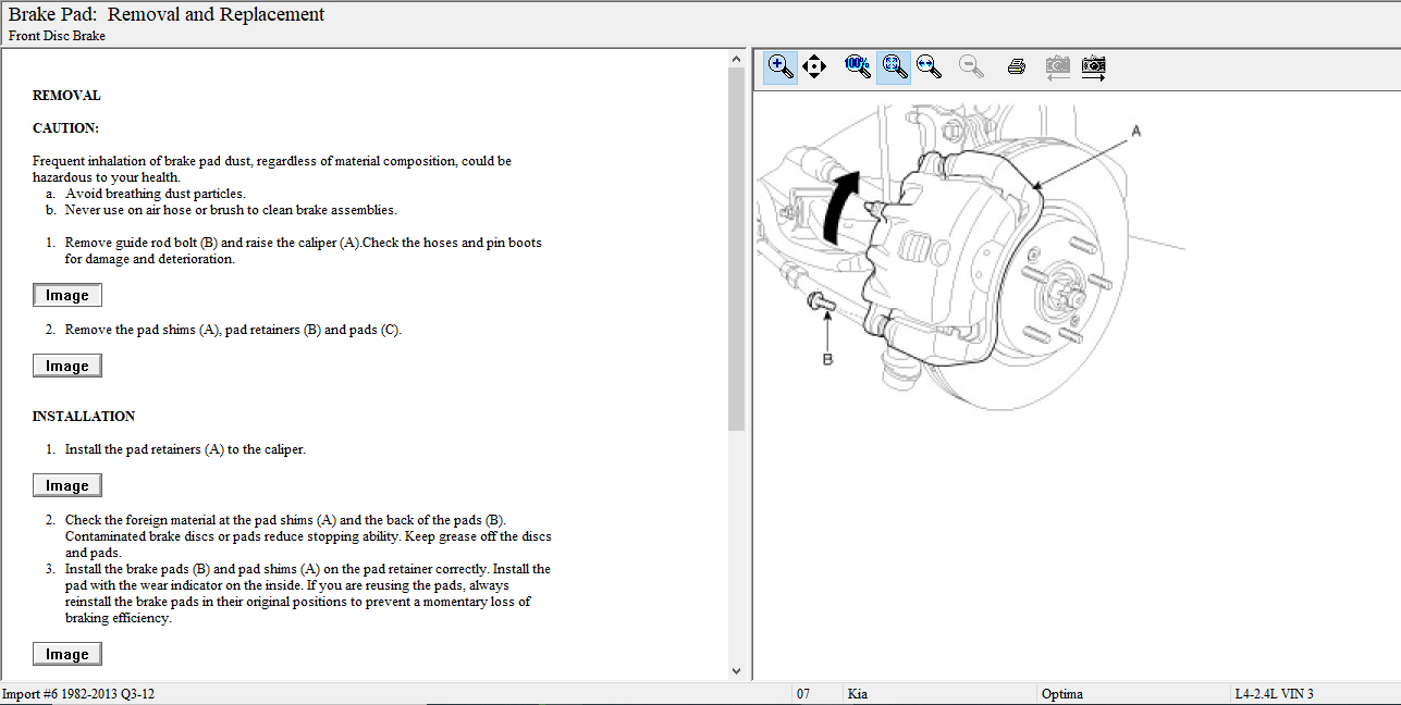

Remove the pad return spring (A) and then remove the brake pad.
Loosen the brake hose bolts (A) and then disconnect the hose.
Tightening torque:
Brake hose to caliper (A) :
24.5 - 29.4 N� m (2.5 - 3.0 kgf� m, 18.1 - 21.7 lb� ft)
Caliper assembly to knuckle (B):
78.5 - 98.1 N� m (8.0 - 10.0 kgf� m, 57.9 - 72.3 lb� ft)

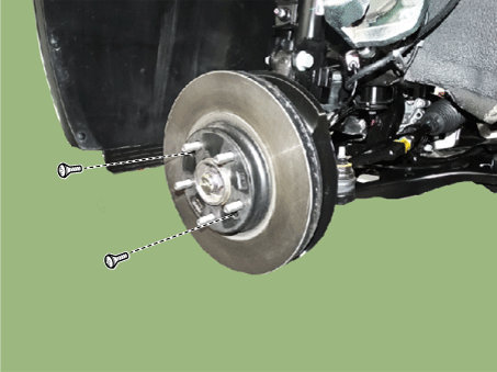

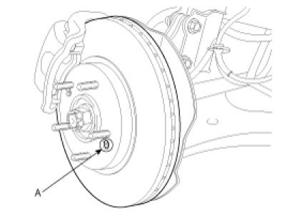

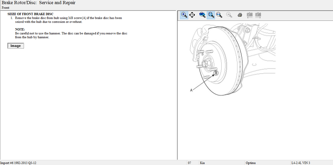

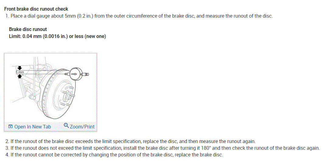

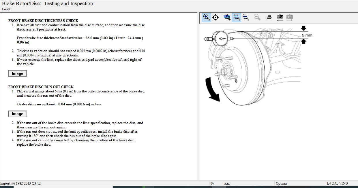

Loosen the screw and then remove the disc.

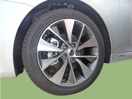

Remove the wheel & tire.
Tightening torque :
88.3 - 107.9 N� m (9.0 - 11.0 kgf� m, 65.1 - 79.6 lb� ft)

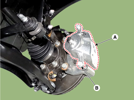

Loosen the Guide rod bolt (B) and then remove the caliper body (A).
Tightening torque:

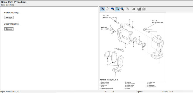

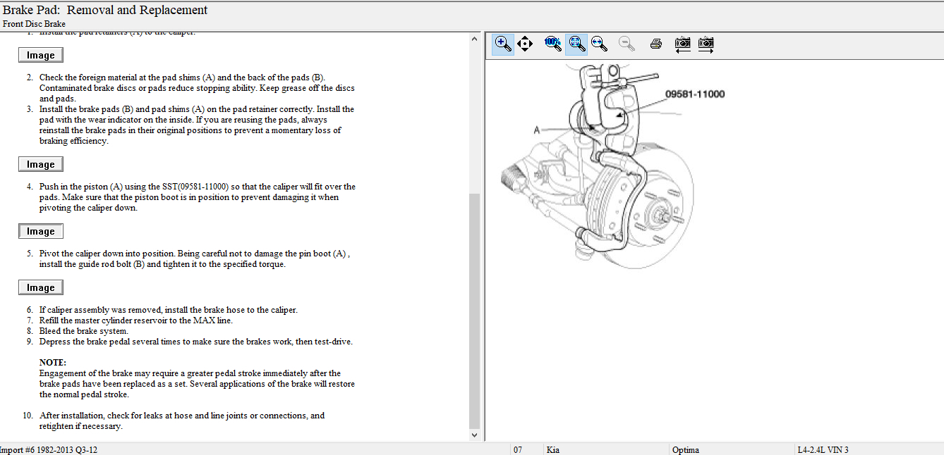

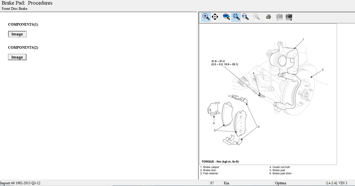

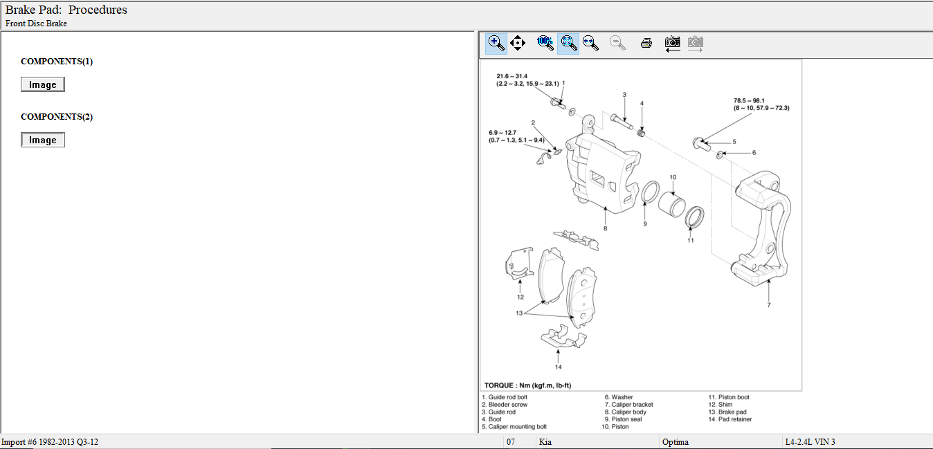

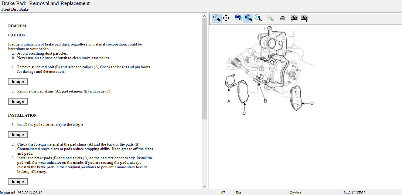

Replace the return spring (A), pad retainer (B), inner brake shim (C), and brake pad (D) all at the same time when replacing the brake pad.

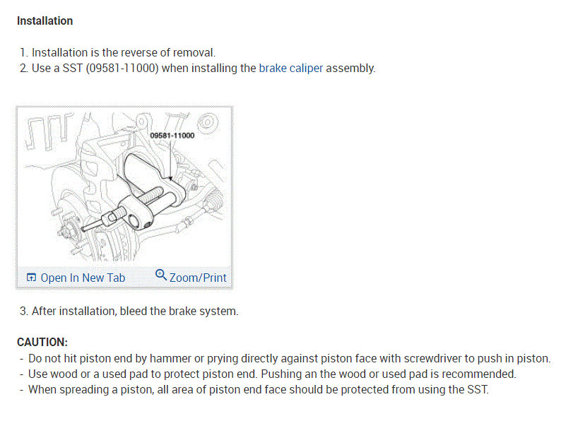

Using the SST (09581-2T100), install the brake caliper assembly.
Tightening torque:
Do not hammer on the piston or pry directly against piston face using a screwdriver to push in piston.

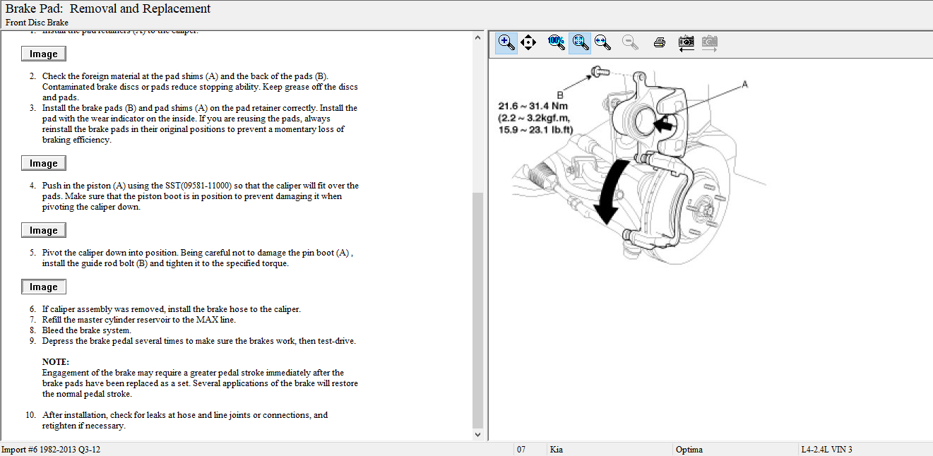

How to use the SST (09581-2T100)
Connect an air hose (B) to the SST after confirming that the valve of the SST is securely closed.
Insert the SST into the caliper and press the caliper piston while opening the valve of the SST slowly by turning it counterclockwise.
Close the valve (A) of the SST and disconnect the air hose (B); then, open the valve again to get the rest of air out and remove the SST from the caliper.
After installation, bleed the brake system.
(Refer to Brake System - "Repair procedures")

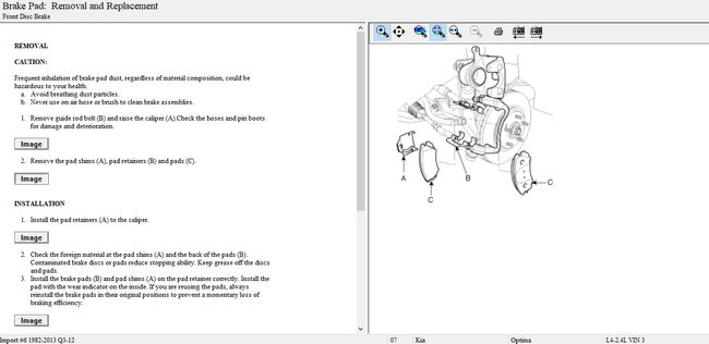

Replacing front brakes and rotors really isn't too hard to do. Make sure to get lifetime pads so you will never have to pay for them again.
You can expect front brakes to last approximately 25,000 miles. However, that can change based on driving habits and terrain.
To get you started, here is a link that explains in general how the job is done. You can use this as a guide.
Here is a video of the job being done on a Hyundai Sonata. Although it is a different model vehicle, it is very similar.
https://youtu.be/7zjHSFVangI
If you look at the attachments, they include the directions and pictures specific to your vehicle. The directions also include inspection of the pads and rotors.

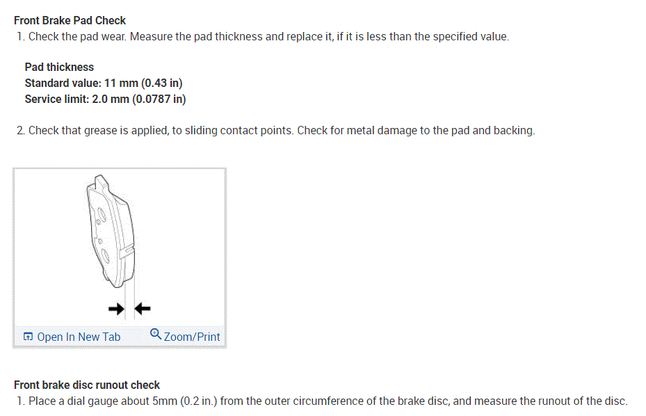

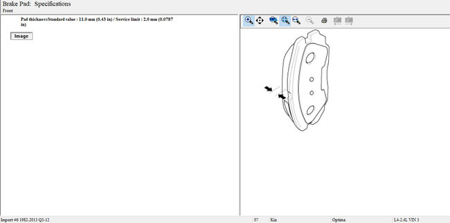

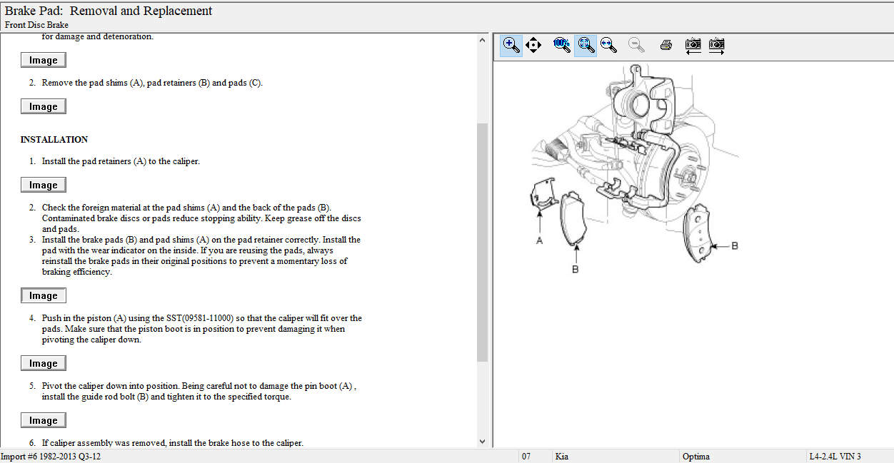

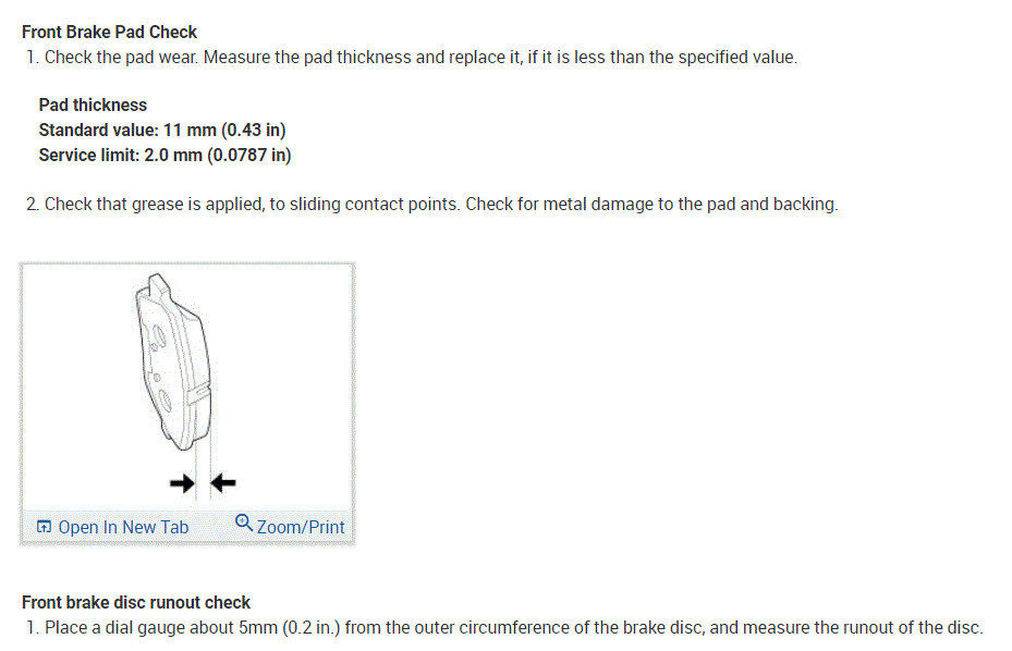

Replacing front brakes isn't too hard to do. You can expect to get approximately 25,000 miles from a set of pads, but that is based on the driver.
First, here is a link that shows how to replace brakes and rotors in general. You can use this as a guide.

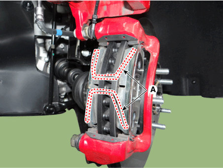

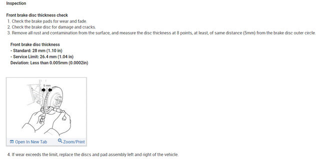

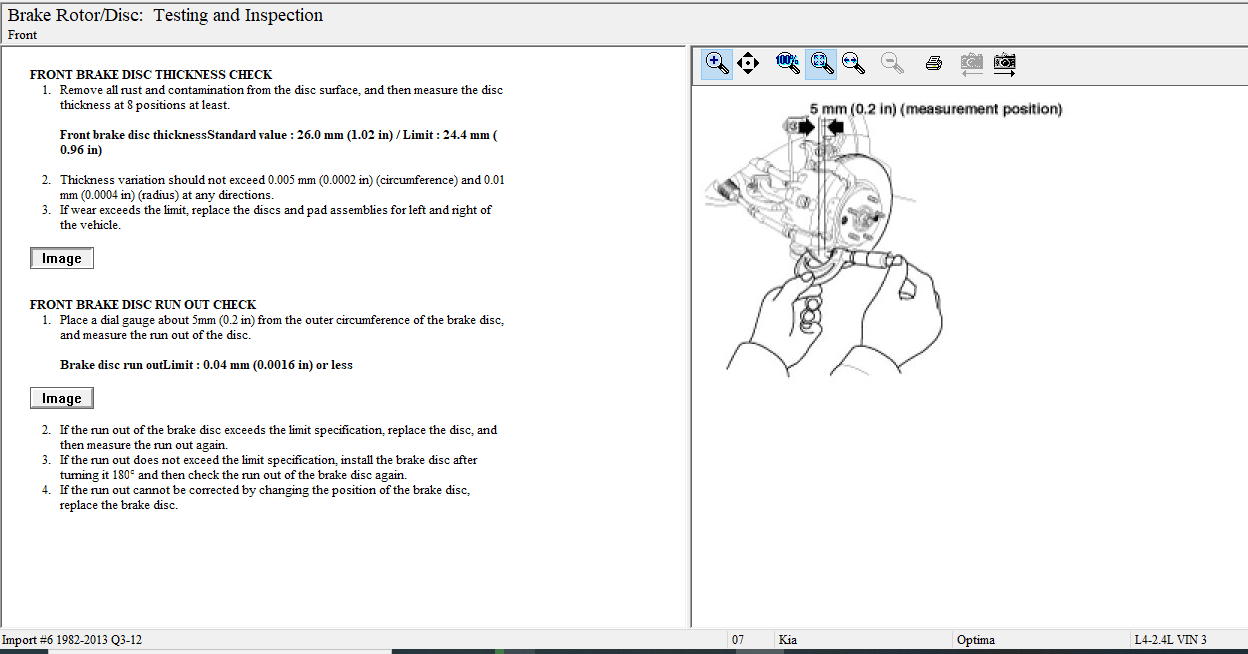

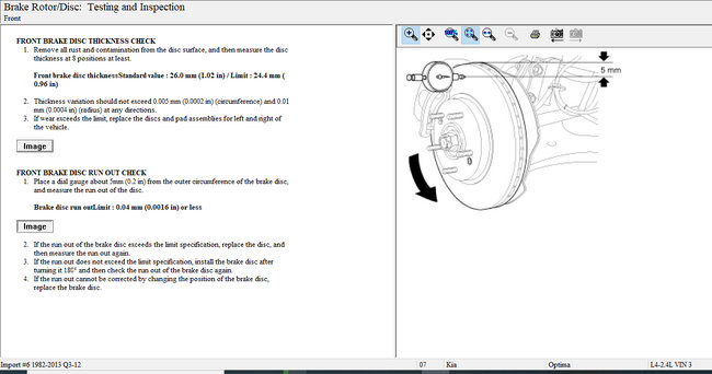

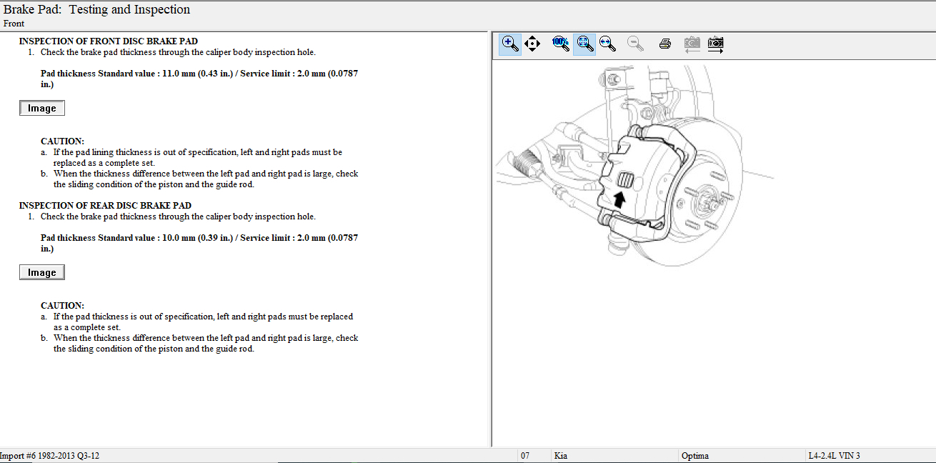

INSPECTION OF FRONT DISC BRAKE PAD
1. Check the brake pad thickness through the caliper body inspection hole.
Pad thickness Standard value : 11.0 mm (0.43 in.) / Service limit : 2.0 mm (0.0787 in.)
CAUTION:
a. If the pad lining thickness is out of specification, left and right pads must be replaced as a complete set.
b. When the thickness difference between the left pad and right pad is large, check the sliding condition of the piston and the guide rod.
INSPECTION OF REAR DISC BRAKE PAD
Pad thickness Standard value : 10.0 mm (0.39 in.) / Service limit : 2.0 mm (0.0787 in.)
CAUTION:
a. If the pad thickness is out of specification, left and right pads must be replaced as a complete set.

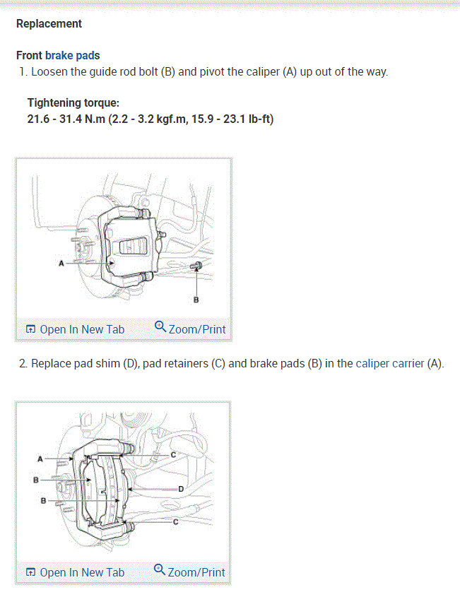

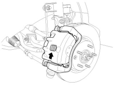

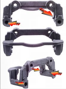

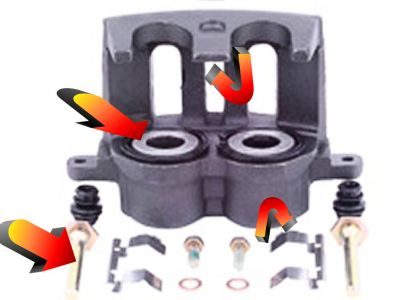

Rmove the lower caliper bolt and pivet the caliper up. Slide the caliper of the bracket-top bolt does not come out.
https://www.2carpros.com/forum/automotive_pictures/30961_kia_1_1.jpg
https://www.2carpros.com/how_to/how_to_replace_brakes.htm
Remove pads, clean all siding surfaces and lube them with quality grease.
https://www.2carpros.com/forum/automotive_pictures/30961_caliper_lube_18.jpg
https://www.2carpros.com/forum/automotive_pictures/30961_caliper_lubeareas_17.jpg
https://www.2carpros.com/forum/automotive_pictures/30961_caliper_lubeareasbrack_17.jpg
Two bolts hold tha bracket to the spindle. Remove them and replace the rotors. IF you have rear drum brakes, adjust them.
