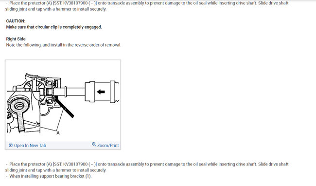

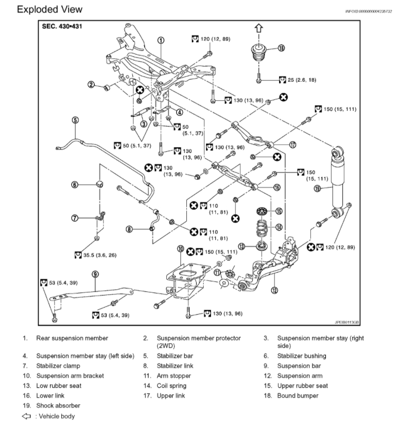

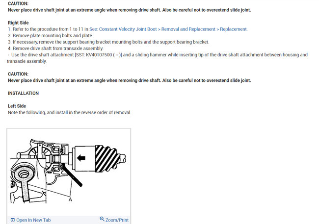

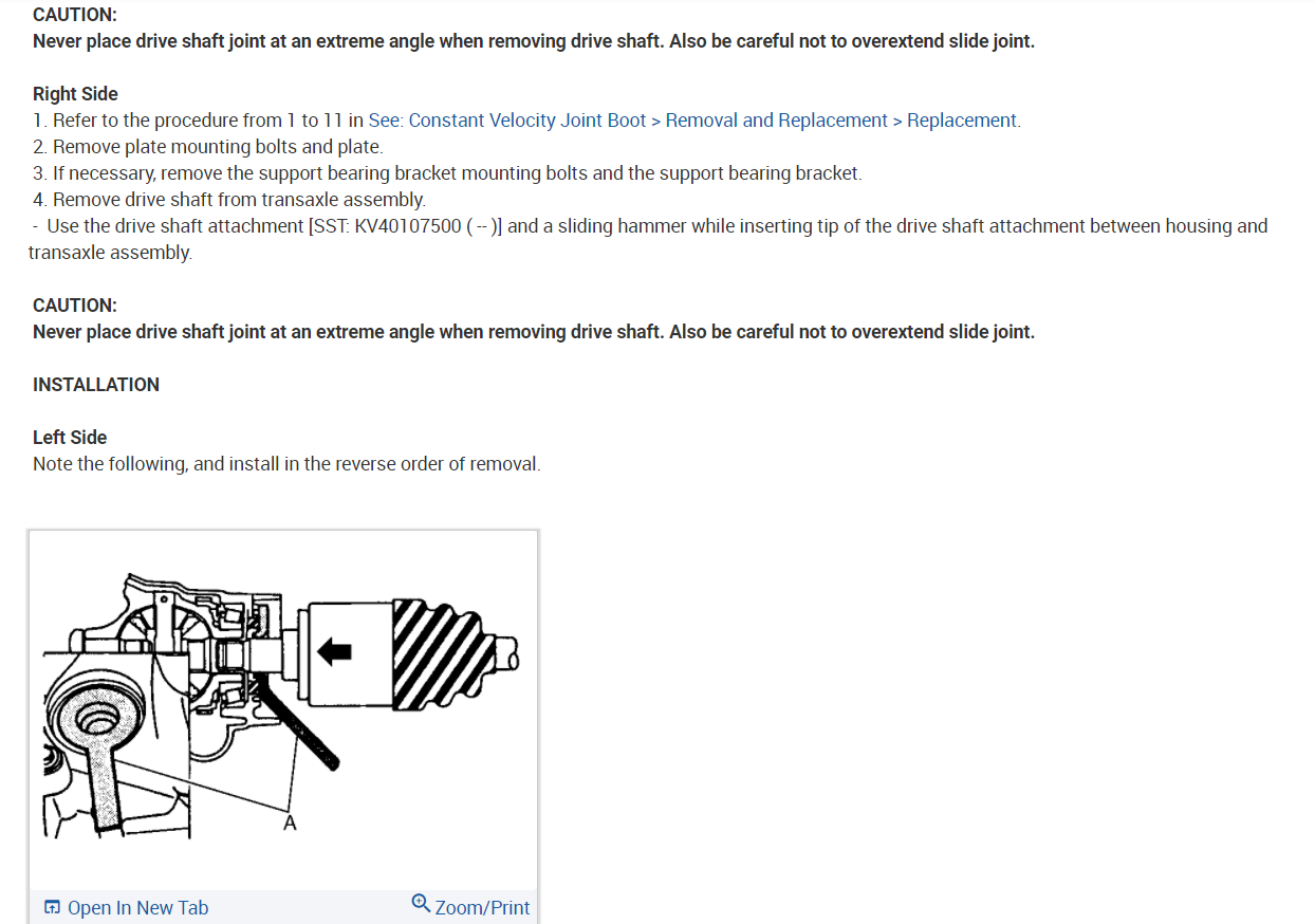

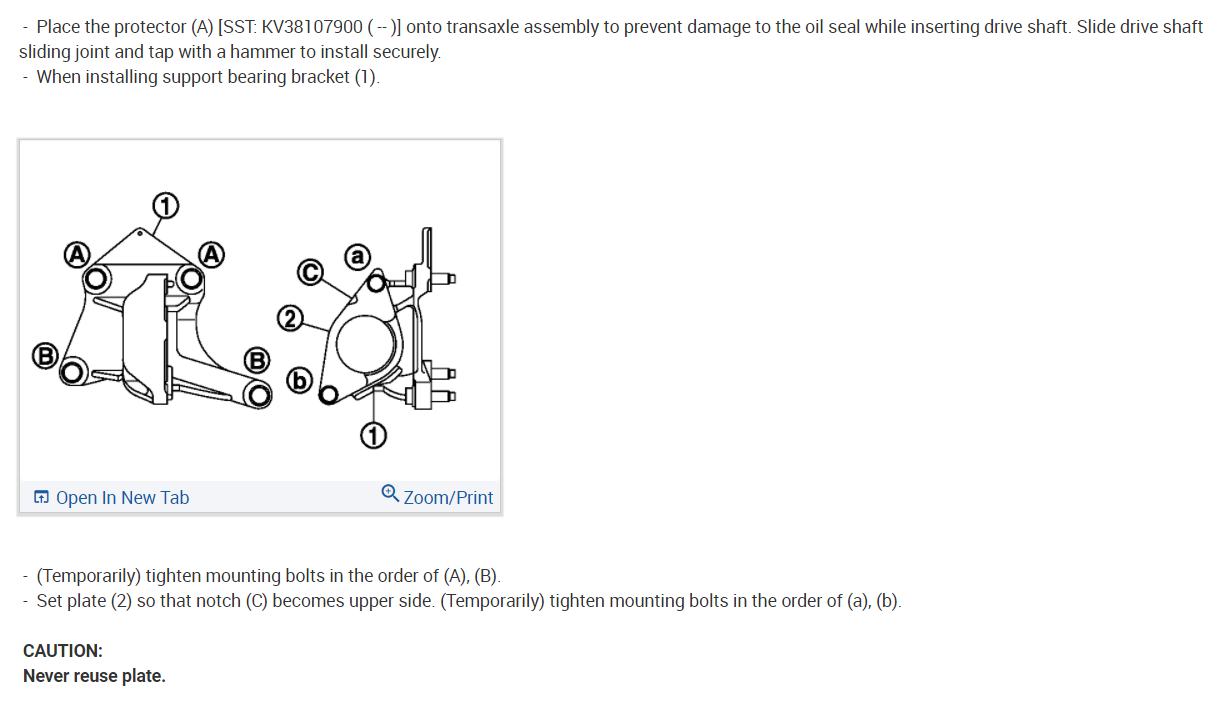

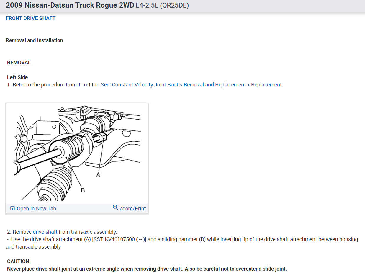

Here are two guides to help walk you through the repair with instructions in the diagrams below to help you with your car:
https://www.2carpros.com/articles/lower-control-arm-bushing-replacement
and
https://www.2carpros.com/articles/replace-cv-axle
